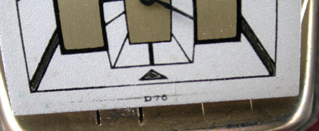

Got the watch today and the code at the bottom of the dial is D76.

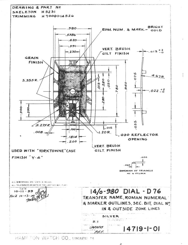

Many thanks to Don for authenticating the gilt dial version for Hamilton's Yorktowne model. Here is an excerpt from Don's email to me:
Mr. Diss,
I have attached a copy of the blueprint for the Hamilton D76 dial. I hope it is clear enough. I am surprised to see that indeed this dial is 100% correct for the Yorktowne. You can see that written on the left 2/3rds of the way down. It was not on any pricelist or in any catalog, but there is the blueprint.
And here is the copy of the blueprint:
D76 Yorktowne dial
