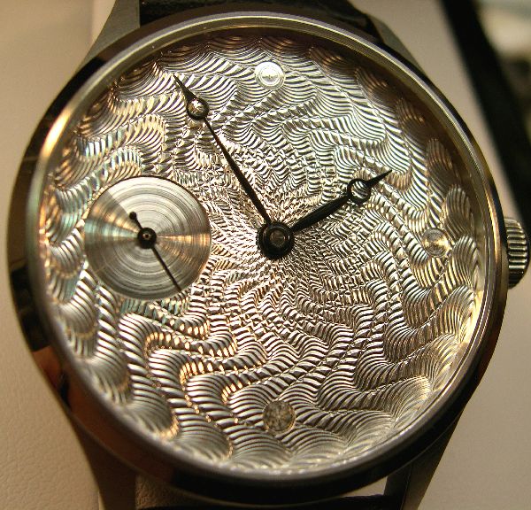

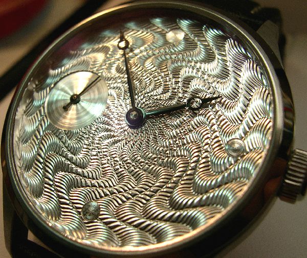

Hate to toot my own horn here but I've finally completed a wristwatch that I have been working on for over a year now. I designed it from the ground up, using the fashionable Unitas 6497. The dial is rose-engine turned...

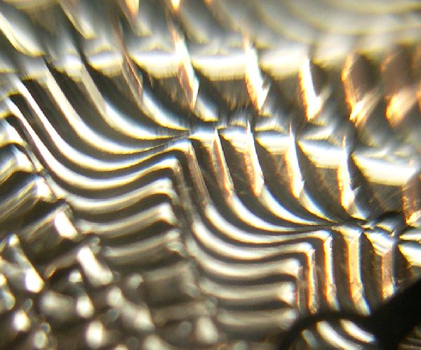

Frank KusumotoDial at 20x magnification. The brass colors are reflections. The dial is fine silver...

Frank KusumotoPhil,

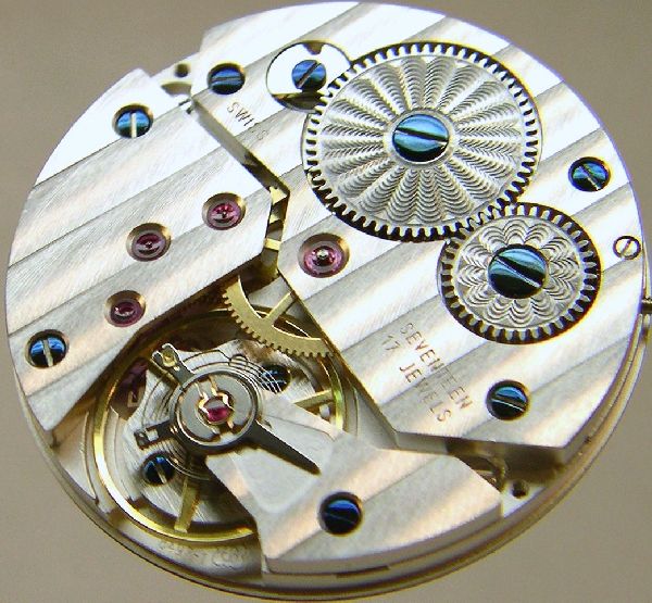

Besides being a watchmaker I'm also a watch producer/manufacturer (i.e., I have my own line of watches). I got a special order for this type of dial and found out it wasn't much more to have ten made than it was one, so I ordered them, all in slightly different patterns. This is the one I'm keeping for myself.
I deleted the "bad" pic of the movement. Here's a better pic of the movement uncased with slightly different patterns on the wheels...

Next up is having the movement engraved to match the dial.

Frank KusumotoSerial numbers are on the side of the case. The silver engraved dialed watches will be #7, #14, #21, #28. The one that I'm wearing is similiar to #7.
