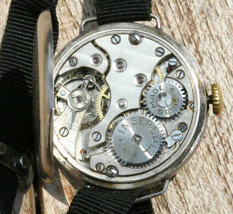

Can you experienced guys shed any light on the 1920's (?)ladies watch below?
The case is .925 silver and clearly struck 'RWC LTD'. Silver assay marks are unclear. The silver buckle says 'English'
The movement shows an Ingersoll wheel without a mounting screw, replacement?
The case screws don't look right but there are no signs of other case screw marks.
The dial is plain without marking.
It runs, winds and sets well.
All thoughts welcome with thanks,
Peter

John WoolseyPeter,
You need to take off the dial to see what is stamped on the dial plate.
At that age, if it's a Rolex movement, it will probably be stamped 'Rebberg'. However, if it's an early Rolco, it may not be stamped at all, The one I have is only engraved on the winding wheel and dial.
As far as I'm aware, Rolex weren't making their own movements back then, they were bought in and finished.
The original wheel if is a Rolex movement, would have been engraved Rolex or Rolco - it may have been lost or used to fake up another movement.
The Ingersol wheel is probably a replacement wheel that just happened to fit, unless Ingersol made or bought in Swiss lever movements
I sold about half a dozen Rolex movements of that type last week!
I'll post pic's of the Rolco I still have plus photo's of those I sold so you can compare.
Best regards
John Woolsey

Peter BlunsdonThanks John,
Look forward to your pics.
Took the dial off today, no Rebberg, Rolex or Rolco just a '56'stamping.
Peter

John WoolseyHi Peter,
Sorry it's taken a while to get back on this, quite a few pic's so I've put them on an image hosting site.
You can view the images as individual pic's or as a slideshow.
Some images aren't that good, but should show enough detail for comparison.
All the movements have been sold except one, so this is all the is.
I'll post shots of the Rolco later.
Best regards
John
You can access the photo's here
http://s95.photobucket.com/albums/l147/Englishlever/WarningIf you get a pop-up stating you've won a laptop computer, DON'T click on the link - it's a con, you are required to sign up to 5x different companies with your CC details to qualify!
JW.

Peter BlunsdonJohn, Thanks for you effort. They are all similar but the one feature that separates my movement is a separate plate , I think for the lever.
Maybe Rolco are different!
Peter
