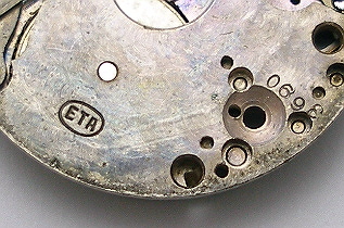

Hello all!
I am in need of some information.  I am trying to repair a very old Benrus wrist watch.  After taking the dial off, I noticed it is an ETA 3690 movement.  I actually need an entire running movement, as this one has a bad hairspring, no stem, no crown, no cannon pinion, no hands, and some plate damage.  Anyway, when I look for parts from a few of the large suppliers and get into the 3000 range, all the ETA movements are QUARTZ.  The 3 in the 3690 is actually offset about half a numer down and a little to the left.  Should I be looking for a 690?  Cant find anything on that either.  Any information is greatly appreciated.
Adam

Cary HurtAdam,
If it's a 10 1/2 ligne round movement, it probably the Benrus "A" series, and it's based on the ETA 390. I'll look around to see if I might have a movement.
Cary

Adam HutiraCary,
Thank you for the reply and I apologize for my delay in responding.  It is 10 1/2 ligne.  If you happen to find a movement, let me know the price.  Below are a couple pictures of the movement.
Adam
