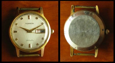

I could use some help on what I need to buy, to open my wristweatches. Most of mine have those indentions in, and around the case, that you use to open it.
Another question is, a watch I just picked up, makes a sound like it's real loose inside, so what should I know, or do, before I try to open it?
This one is called a Tourneau, and you can see the back I was talking about.
Sheila
Tourneauw

You need a couple of things to open cases similar to your Tourneau... a case holder and a case wrench.
Check out this page for holders: http://www.julesborel.com/horological/page131.htm
I have many more expensive ones, but the second one listed on this page is actually pretty good for the six bucks. This case holder can be held in a small bench vice.
Wrenches:
http://www.julesborel.com/horological/page136.htm
I have to recommend the second one on this page as it's of much better construction than the $13.95 one. The cheaper one is OK, I guess, if you mainly intend to open lesser expensive watches. You will sometimes find the $44.95 model on eBay for much less, in used condition. Sometimes it may be labeled "Vigor" rather than "LG", but it's the same wrench. Just make a mental note of all the attachments you see in the pics, and be certain that a used one is equipped with everything before buying it.
Always try to open a watch over something that will catch anything that falls out. This is especially important when you hear something loose inside. There is a "catch tray" on most watchmakers benches that addresses this issue. Just go slowly, adjust the wrench for a proper fit, and try not to let it slip, or you'll end up with a scratched case back.
BTW, I have no affiliation with Jules Borel other than purchasing from them as a customer.
Gene
