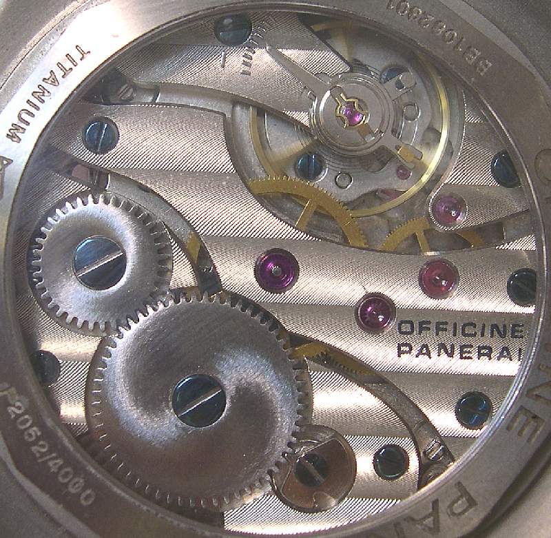

Frank KusumotoThey were getting "scary" good, now they're "scarier".
I found this fake Panerai and was taken aback. It had the train bridges of a real Panerai. ETA doesn't make this movement for anyone else. So there's two ways to get them... steal them from ETA or make your own. The workmanship on the watch is pretty good. It has actual bevelage on the bridges that is pedestrian but good. The fake geneva stripes, that I believe the russians invented back in the 50's, is executed well. Running wise it's close to chronometer standards tested out to positions. The watch was pressure tested and it came out to 15 ATM's. So here is this watch that costs less than the movement inside it and a cup of coffee, and you get a real watch, a real good watch. I don't get how they do it. The "faking" aside, this is a $1000 watch easy with any name on it. I knew four or five years ago that Asia was going to change everything. I've been predicting and preaching big change for a couple years (Sea-Gull Industries!). But oh boy, I didn't realize they were going to make the Swiss just a ...
