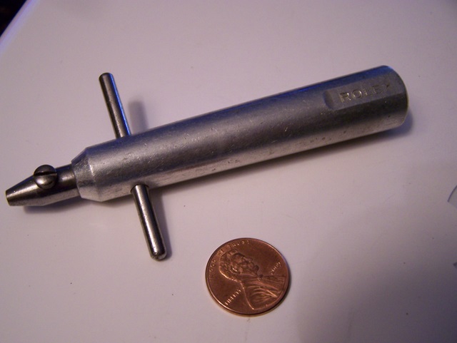

Eugene BuffardRolex tool what is it used for.
Does any one know what this was used for???

William ThomasPossibly a reamer holding tool for the case tubes???

Ernest C. BarnesCorrect. I have the same tool in the shop for removing/inserting case tubes.

Eugene BuffardThe hole in the end is smooth. Is it missing some thing. I would of thought it would be threaded. I've never reamed a case out to install a tube. I was always taught make the part fit the watch. not the watch fit the part.
