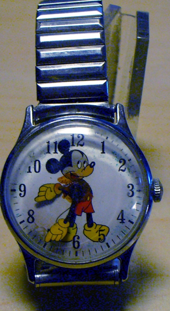

I have a MM wist watch in very good cosmetic condition, which will run for an hour or so and then stop. I need to get it out of the case but for the life of me I can't see how it comes out. I have tried stem in and stem out, pushing on all the spots and still can't get the stem out. The unit was made by Walt Disney Productions.

side and back picture please

Patrick, can you take picture of the movement?
Some of these MM watches had Timex mechanical movements.

Photo of mvmt. US Time is stamped on the back.

Patrick. The movement is made by Timex. If you loosen the screw next to the stem in your picture and lift the lever (detent) the stem will come out.
