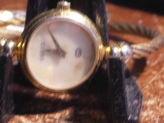

Can I get help in, How do I open a case of a Gucci wristwatch model 2700 L. I'd like to change the battery in my Moms wristwatch,Thank You Rick

Here are photos of the watch
In case needed
Thanks

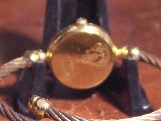

ONE MORE PHOTO
SORRY OUT OF FOCUS

My first guess was the watch would most likely have a "snap-back" which is typical on small wristwatches and now I am more certain from your pictures. Looking very closely, the back is not perfectly centered, which also helps in the determination. Placing a blade just inside one of the lugs should allow you to "rock" the blade in order to "pop" the back, look very closely to see if one permits easier access than the other.
It is also possible the back was removed by placing a blade along the side opposite the crown. Examine the case closely for any signs of where a blade has been inserted previously.
The back should release fairly easily, just be careful. Once the back is off you should be able to see the battery number. There are interchangeable numbers, if you post the one you see on the battery we should be able to help with what might be the most readily available. You will likely see one or more screws holding the battery in place. If you are not familiar with this operation draw a diagram of how it goes together. Doing so will make re-assembly far easier because it may be a day or so later when you re-assemble.
You will probably find there is a fine gasket around the edge of the case-back. That helps with water-resistance and it is very important to have it properly in position before you snap the back into place after battery replacement. Do this slowly and carefully. Carpenters say... "Measure twice, cut once" ...which is always good advice no matter what you are doing, especially in complicated matters.

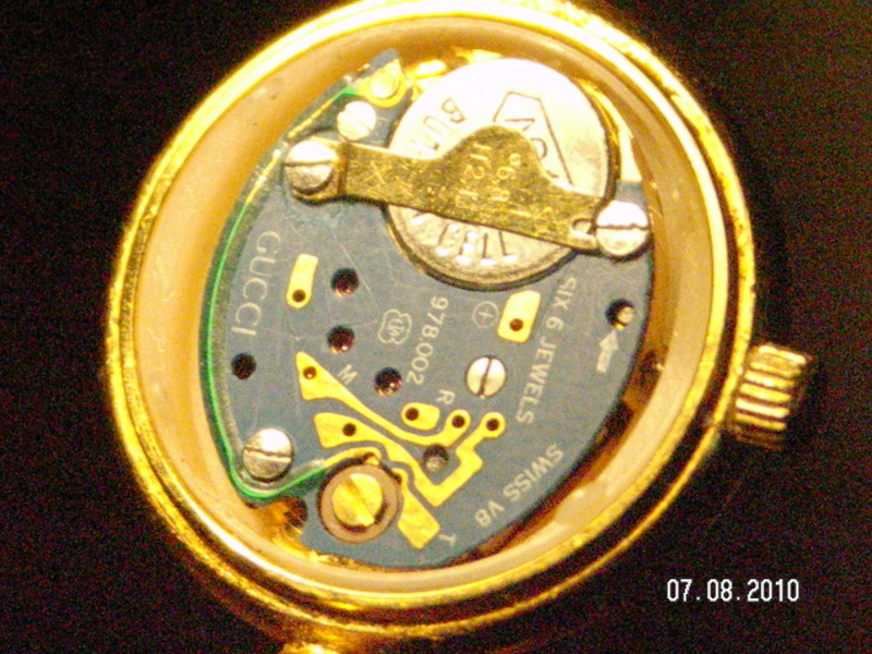

Hello Guys I wasn't successful in getting the watch to work. I replaced the battery and checked for water damage, and found none. The watch still did not work despite the change in battery. How can I go about changing the movement and where can I get one. I'm attaching another photo for reference. I appreciate your support in advance.

Your movement is now obsolete, a interchange would be Ron 751E you will then need to adjust the stem/new crown for the movement and maybe the hands will need fitting also. If the watch is important and no interchange it is possible to disassemble the movement and clean the train section as you would with a normal watch and (maybe not in your case) replace the circuit, given the cost of most modern quartz movements a replacement is the way ahead. For the last of the days work today I replaced four they are relatively quick and easy to do for the most part.
