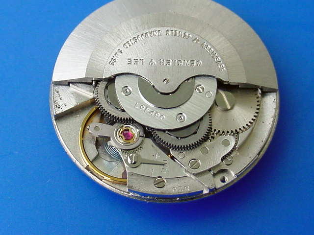

Can someone tell me which company made this movement,,i need to order a winding stem for it..
it is marked gensler & lee # l9f490 also marked 6zr on the balance cock..
Thanks in adavance.

Cary HurtSamie,
That's a tough one alright. The rotor table is pretty unusual, and I've never seen another with an offset regulator set-up like that.
There appears to be some writing on the top side of the barrel. Can you make that out?

Samie L. SmithCary
Thanks for looking i can,t figure this one out either and your right a unusally regulator,,that,s open you see writing on the Barrel ..also has what looks like a solid gold balance.
This is a nice watch in a 14k js case and a beautiful Diamond dial.

Evan MorganI think I found it!
It seems to be a Zodiac movement from the late 1960's. More information can be found here:
http://www.ranfft.de/cgi-bin/bidfun-db.cgi?10&ranfft&&2uswk&Zodiac_70I found some other information that suggests that Gensler & Lee was a jeweler in the San Francisco area. The mark on the movement looks more like a "GZR", which is probably the import code.
Hope this helps,

Samie L. SmithEvan thank you so much for the information i know you have spend quite a bit of time finding the info and i do appreciate it.
I think you have it right thaks to you i now know what to look for in a stem.
thanks again

Cort MooreEvan beat me to the punch! I was in my Zodiac box today and recognized that regulator from this post the other day. The movement I was checking on was a power reserve model but the basic movement was a Schild 1225 (I think!).Others in the box (I recall a 70-72, but three others too) all had that same regulator. Anyway, it's easy to find in Bestfit under Zodiac. The stem should be easy to find but, if not, I could help. Gensler-Lee is an old S.F.jewelery retailer.
-Cort
