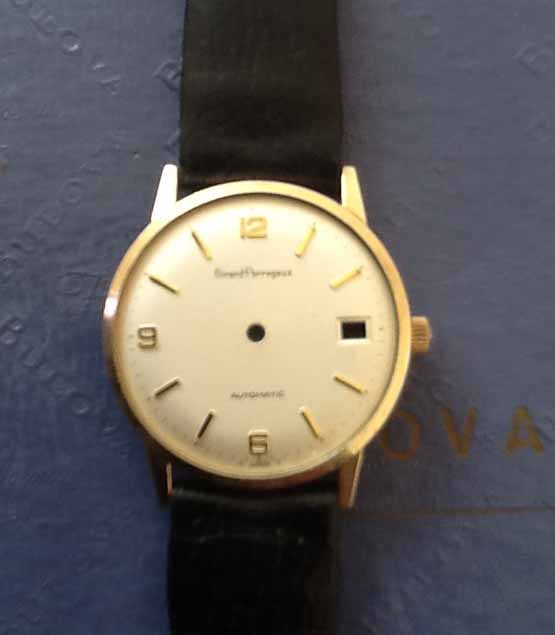

Pictures of the watch might be helpful.

Darren SandersCase

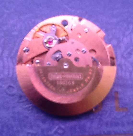

Darren SandersMovement. Sorry bout quality. Did my best getting the shots with my back pain.

I've taken the dial off to check the motion works. The hands were not moving because the cannon pinion is loose. I've read online that this can a problem with day/date watches because you have to go from 22h-24h back and forth to set the date. I think that I'll have to find a way to "tighten" the cannon pinion or get another.
One thing I like about this movement is the fit/finish. Most of the steel parts are mirror polished (even the cannon pinion is brightly polished. Most of the watches I've worked on before (from Elgins-bulovas) don't seen to have the quality this one has.
