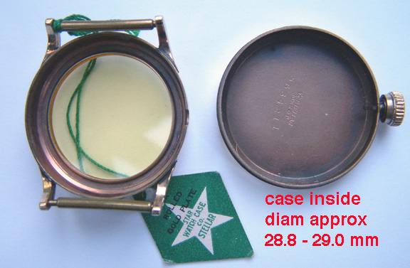

Pic. shows a case for a negative set small pocket watch movement. The question is -- what size ?
The internal diameter of the back varies a few tenths of a mm below 29 mm, depending on where it is measured. It could be size 0, 2, or perhaps even 3 ?
Dan.
caseback

Hi Dan,
A 2/0 movement at 28.78mm looks to be a good fit.
Joe

I think it is for an 0 size movement.The outside rim of the movement is larger than the main body of the movement.The case it fits in will be smaller than the rim.
J Smith

If it's the same as this one...
which has the same markings and measurements as yours, then it's for an 0 size. Mine holds an Elgin 0 size with it's dust ring intact very snugly.
Cary

Thanks for the notes. Now I need a Hamilton 0-size movement and dial and hands !
dan
