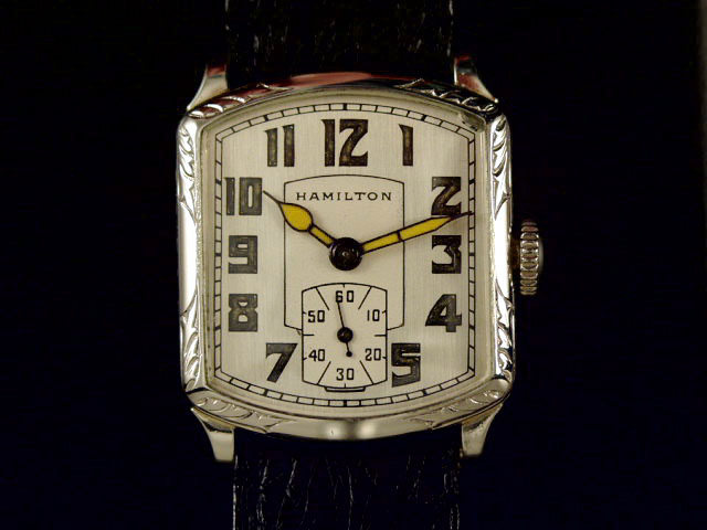

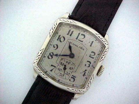

Here's the dial & hands on my Hamilton Tonneau (engraved) white GF. Movement serial number 4,100,000's vintage
May 24, 2005, 21:22
Barbara BarnesHere are my questions:
Is this an original dial variation? (I've only seen the luminous numbers with skeleton hands).
If this is original & correct for the watch, would dial restoration be in order or would it be better to leave as is?
How do you make a determination to have a dial restored and what factors prompt your decision?
Are Hamiltons better left original?
Thanks!
Barbara
May 24, 2005, 21:39
Gary ColeBarbara
I am fairly new at this, but let me try.
This is a correct dial version, the luminous was a more popular choice and an upgrade ( for a fee )i believe over the black enamel numbers. I like this style, it is a nice change from the luminous numbers

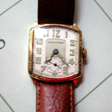

As far as refinishing goes, it is a personal choice. I have one watch where the patina adds to the "look" of this particular watch, in my opinion.
It is located in a thread further down on this page.
That being said i just sent 2 dials out to be redone since they were so bad. If the dial is bad enough, i would have it refinished, each threshold is different. There are some other threads about refinishing which offer some thoughts as well as pics.
I would keep the dial for a while and decide after wearing it a while. You can always have it done down the road.
If I am wrong on the dial info, I am sure some of the experts will chime in and correct the information
May 24, 2005, 22:29
Rich KuhnThis is a correct dial however the hour hand is wrong for this dial. As to re-doing the dial that is up to you if it were mine (for my colection) I would not do this one. If I planned to sell it I would have it done.

William J. Hansen, Ph.D.Greetings,
I agree that this is an original variation of the Hamilton Tonneau dial. I really like the look of the enamel dial, rather than the luminous dials. Often, luminous redials turn out way too "bright green", and looks odd to me. It reminds me of a face lift on my grandmother.
As for your dial, the decision to redial is a personal one. I always prefer an original dial, until the dial begins to take away, rather than add to my appreciation of the watch.
If the watch were mine, I'd redial. International Dial could do a fantastic job for under $25.

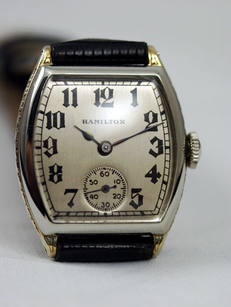

William J. Hansen, Ph.D.This is an exmple of a solid gold two tone Hamilton Barrel, a watch from the same era as the tonneau. Here you will see an enameled dial, and what I believe are the correct hands.
Bill Hansen

Bryan J. GirouardActually, that style of dial on the Barrel came with blued-steel elongated diamond hands quite similar to those used on the Piping Rock and Coronado... and Barbara's Tonneau. Or the squat, stylized dimaond hands, maybe. I'll dig through my stuff to find either a catalog illustration or advertisement showing the proper hands.
Those hands don't diminish the beauty of that gorgeous watch, though! It's awesome Bill!

Barbara BarnesGary, Rich, Bill & Bryan ~
Wow - thank you for taking time to post & for sharing your input!
I have a much clearer idea of what I want now.
I'm leaning in the direction of redial and probably not the luminous numbers. I like the simplicity of the plain black numbers on a satin background. I think when redone the numbers will "pop". I've only seen examples with luminous numbers so seeing Bill's Tonneau gives me a better idea of the potential for my watch.
Bill, you are right about membership in IHC - the collective knowledge, information, perspective, opinions and experience from all walks of life throughout the world - what a deal! My investment in membership dues has already paid dividends!

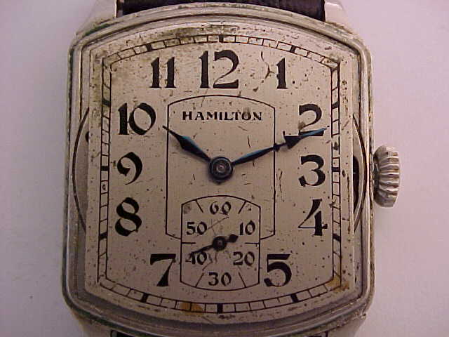

Barbara BarnesHere's the full before photo. I'll post the after when it comes back.
My last experience with International was sloppy work and several returns. Still not corrected to satisfaction.

Will RosemanHi Barbara:
I agree with everyone else - the dial is correct and the minute hand is correct however the hour hand and crown are not.
The question regarding redialing the watch very much depends on what you prefer. I personally don't redial unless the dial has been redone once before (and most have been - even if they don't appear to be). If that is the original dial and it has not been refinished, I would keep it that way but in the end, it really depends what your personal preference is.

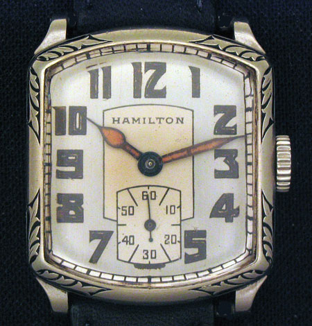

Below is a mint Tonneau Engraved from 1927 (the year the Tonneau was introduced). This watch has the original dial, crystal and even came with what I believe to be an original metal band. The watch still retains its brush satin back cover and spends each night in its original box with its original papers. The watch appears to have never been overhauled as there are no markings on the inside of the case whatsoever. It's about as close to a NOS Tonneau as I've seen.

Barbara BarnesIf the hands are incorrect for the watch, what style is appropriate and what's the name of the hands - skeleton, spade, etc?
What do I need to know to purchase hands - what should I be prepared to know - do I give the watch make & model, movement grade, pinion size, etc? (Is that the correct part that holds the hands?)
Where can I purchase hands? ebay? supply house?
Who's on first?
All joking aside, I really do appreciate your help. I am learning so much.
May 26, 2005, 07:18
Rich KuhnIf the watch was mine I would look for an hour hand that matches the minute hand in style. I will take a look through my hands and see if I have one that will work on a 987 movement. Give me a few days.

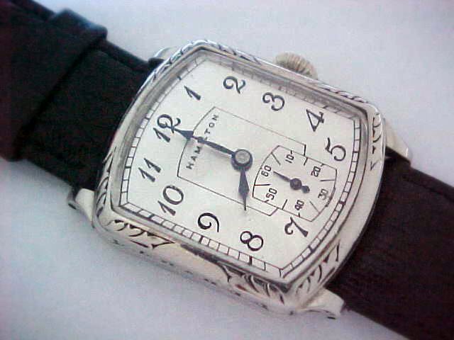

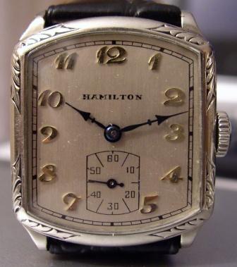

Frank WilsonHow many have you seen with raised gold numerals?

Frank WilsonThis is how it looked when I found it.
May 29, 2005, 19:14
Barbara BarnesFrank, your watch is gorgeous. Thanks for posting the pics!
