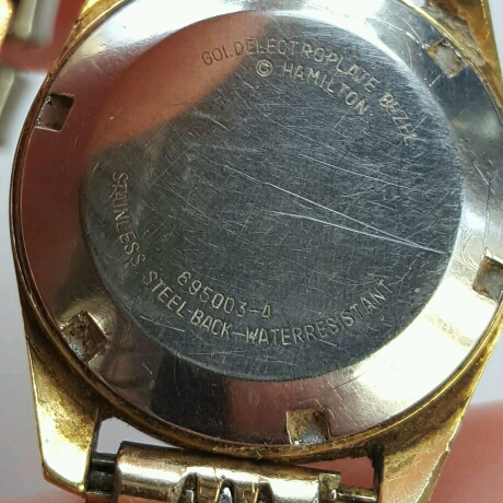

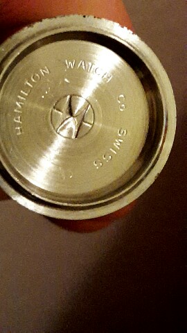

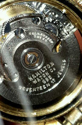

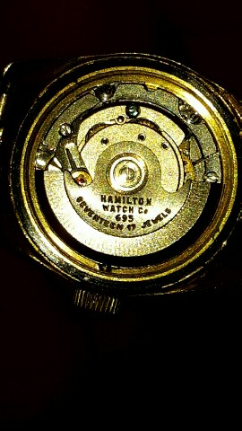

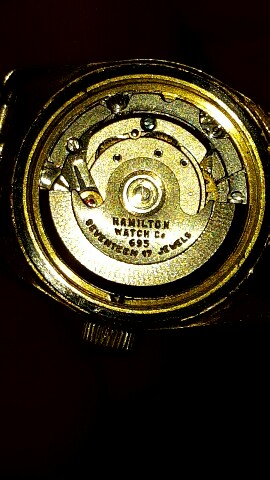

Ashley CanfieldWell! I got the back off... and it didn't reveal much at all. Hamilton "695." (I already knew that, thanks!
Anyhow. Here's what I've come up with.
Dateline LA-5401 circa. 1971? 1/2 plate. Gold plated.
That's all I got.
January 03, 2017, 08:59
Ashley CanfieldI do know that it's 1/2 plate.
January 03, 2017, 09:22
Billy KuhnThat is an ETA movement. Look under the balance wheel you will see the ETA caliber number.
January 03, 2017, 13:43
Ashley CanfieldDo I have to take the whole plate off?
January 03, 2017, 20:40
Eric KaufmanCONGRATS on getting the case back off!
No need to remove anything. Just tilt the case so the auto wind rotor moves to the other side and you should be able to see the ETA marking.
