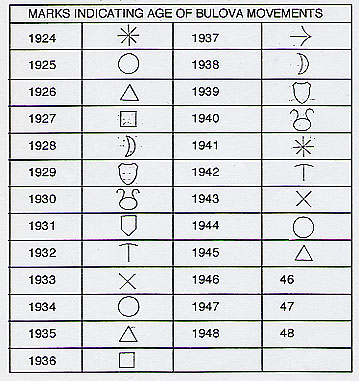

Bruce Shawkeyother bulova movement markings. I took this off an old Bulova service bulletin. '46 through '49 are sometimes marked "A6", "A7," etc. Then, starting in 1950s, they went to "L", such as "L0" for 1950, "L1" for 1951, etc. Note how the marks repeat every 9 years (for the most part). Guess you have to guestimate the age of the watch based on the case to know when the movement was made!

Jerry TreimanPretty Neat !!! I guess that might put my
BULOVA PHANTOM at 1926 (triangle stamp next to the detent screw). I am pretty sure that it is earlier than the mid-30s (the next use of the triangle).

Barbara BarnesBruce,
Thanks for posting this reference table. I have seen those odd markings on my Bulova's and was told to concentrate on other things when I inquired about them. I'm presuming it was because no one had the answers.
Rather primitive - why not just print the date? Then a key or translation would not be necessary!
