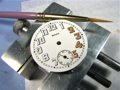

Last year I bought a 1920's Rolex wrist watch from Jones & Horan. At the time of purchase, the radium was missing from the dial and the hands. The following shows the process I used to replace the missing radium with acrylic paint (much safer material). This first shot shows some of the numbers having been finished.
July 28, 2012, 12:03
Bruce StewartThis shot shows progress after about an hour and a half. Acrylic is fairly easy to work with and can be scraped off the dial if you don't like the final look.

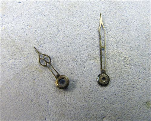

Bruce StewartThis photo shows the condition of the hands at time of purchase. To restore these with the acrylic, I put frosted tape on the front, then painted in 4-5 coats of acrylic into the recesses of the back side. After allowing to dry, tape can be peeled off safely without damaging the paint. After doing the minute hand, I decided I didn't like the fact that the metal was much thinner on one side compared to the other. I dug through my inventory and came up with a replacement. The replacement turned out pretty good.

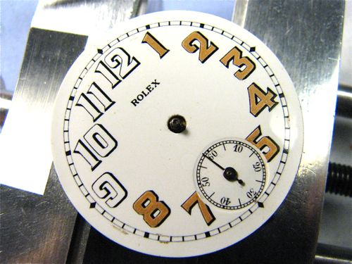

Bruce StewartHere is the finished restoration. Watch is triple signed and is quite accurate over a 24-hour period. The case is sterling silver and the movement is a 13L Rebberg.

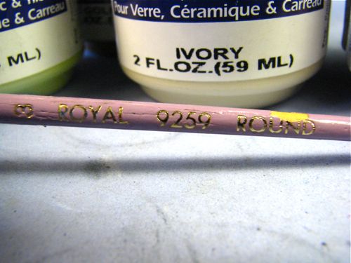

Lorne WasylishenVery nice work Bruce, you must have a pretty steady hand. Can you tell me what type of brush that is and what brand of paint you are using?

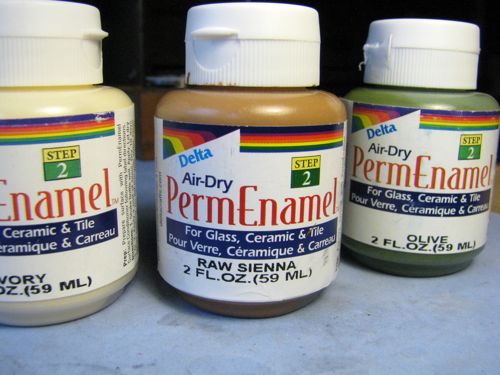

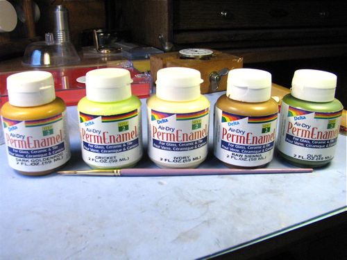

Bruce StewartLorne, here are some shots of the paint brand and brush. I bought everything at Michael's Craft Store. For this Rolex I tried to mix up a color that matched a small piece of radium that was still present in one of the hands. To arrive at the right hue, I mixed the raw sienna with some ivory.

Bruce StewartHere is a close-up of the brush. I can't remember if it is synthetic or natural, but I'm pretty sure I stuck with synthetic when I bought it because of the paint being water-based. A natural bristle brush will tend to get "frizzy" when used in water. One other note, I am pretty sure this brush came out of a set of 5 or 6 brushes (much cheaper that way).

Bruce StewartHere is a close-up of one of the paint bottles. When I went shopping for the paint, I didn't buy just one bottle...I bought each color that looked like old radium I have seen in the past. Even then, I still usually have to mix the paint a bit to arrive at just the right color. Hope this all helps
