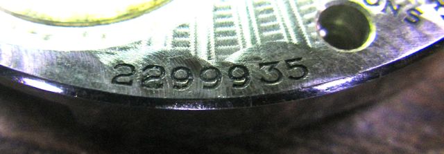

Hello everyone I'm in need of some info on this Bunn Special. Serial # does not match up with any data base. # 2299935

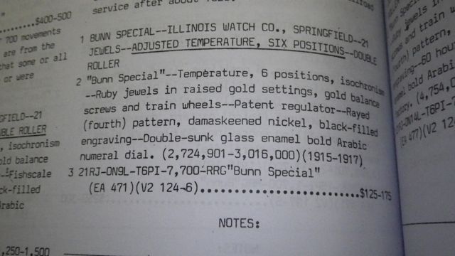

Here is what Meggers & Ehrhardt say about the Wording on this Bunn Special.
But check out the serial # range.

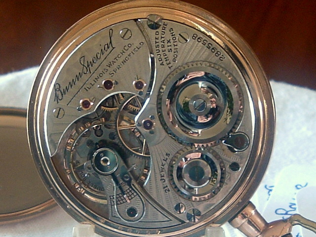

The pocketwatch database says it is a size 0.I have
a Bunn Special marked like yours s/n 2895598.It falls within the s/n listed in your post.
Roger
a

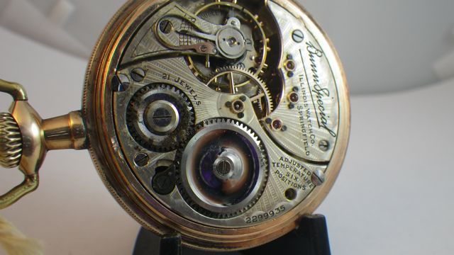

I did a little more detective work.
March 25, 2014, 21:40
Eugene Buffard
It looks like a mis-stamp from the factory.

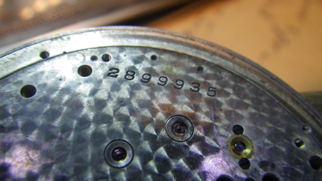

The balance arm.
March 25, 2014, 21:45
Eugene Buffard
The 8 is not stamped all the way. Serial # 2899935 Not 2299935

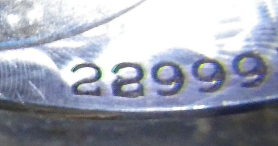

Eugene Buffard
The top of 8 on the left side. not engraved.

Eugene Buffard
I added black back in the numbers. For definition.
