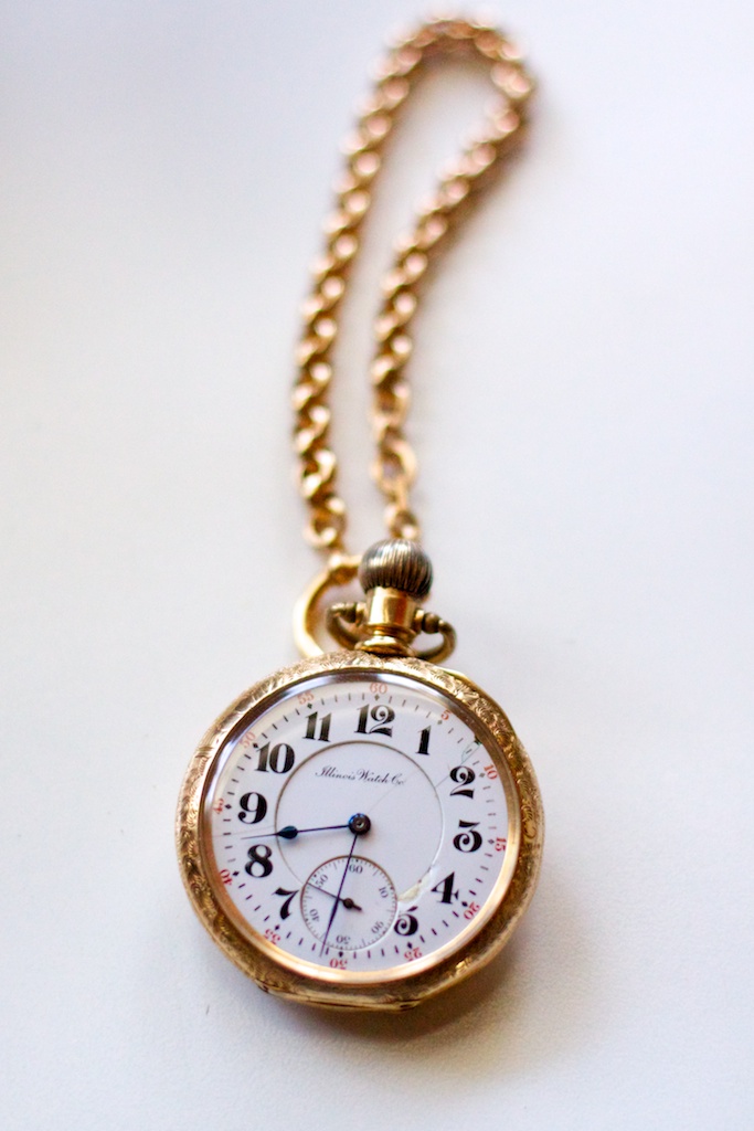

Hello to all! This is my first post to this forum.
I would like to get some info about my family memorygift watch. Originally a gift from my great-grandfather. My great-grandfather gave this watch to my grandfather when he was born in year 1925. I think this clock is made in year 1909? After my grandfather died at age 36, this clock went to my father. One year ago I got it from him, when I married. Someday I hopefully can give this to my children as well. This watch aint workin or running. Any ideas what would be the cost to repair it? Any info about this illinois watch or the case would be very appreciative.

Jari -
Welcome to IHC185! Your watch is a moodel 5, grade 176, and one of 1600 made in this grade with 17 jewels. It is a very nice watch!
Without knowing what is wrong, a repair estimate is impossible, though.

Your watch is indeed from 1909 and is called a "getty" type movement. It is either a grade 174 or 176. If the serial no is 2151442 it is a grade 174 of which 15,670 were made. If the serial no is 2161442 it is a grade 176 of which 2,210 were made.
It appears to me to be a grade 176 with the 4 positions markings etc.
Your case does have a 14K marking on it. It could be a solid gold case, but I am not sure without seeing other case markings as should be on the other lid [back cover]. If it is solid 14K then the case value would be upwards of $600 as gold is at an all time high.
Your watch can be fixed and a ballpark estimate would be $75-175 depending if any parts are/will be required. There are a number of qualified repairman on site that can repair your watch.

Absolutely beautiful family heirloom. My fathers watch is of similar vintage; it sat around in drawers for many years and when wound would run. However recently it quit; that doesn't necessarily mean its "broken". It may only need "servicing" or as it often called COA (clean, oil, adjust). They used to use natural oils (some still do) to lubricate watches, through time they can harden or lubrication can be lost and the watch doesn't run properly or stops. You can pay $60 or up to 4 times that for a COA, depends on the watchmaker and if parts are needed. Very often in doing a COA they find other items that should be replaced. Since this is a family piece you hope to keep in the family it would be worthwhile to consider having it serviced.
There are many competent watchmakers and service technicians on IHC185 who can help. I'm sure some will contact you, never met anyone on this site who has not been of the highest integrity and desired to help. They will likely help you assess the watch in terms of issues; but as stated above no one can determine the cost without the item in hand, and even then its a professional guess (estimate).

I'm so happy that finally someone could define this watch. I will call to my dad tomorrow and tell him the good news.20-30 years ago my father tried to ask service on this watch at local jewellery shop here in Finland. They didn't know how to help him.
It could be that this watch needs only oiling and other basic repairing. One thing though that needs repairing is the dialing plate. Those cracks are so apparent. The serial is endeed 2161442 (double checked). and here's new photo of the lid back cover. Can someone trow a wild estimate how much this watch is worth.

The new pictures shed a bit more light.
Your case is solid 14K and made by Keller & Untermeyer.
Your dial needs replacing and if one is patient you can find a double sunk one on the many market's in great shape for $125 or less. Your watch requires the 16sz dial with feet positions of; 24.5/36.5/55.5.
I would estimate that your watch has a value of $700-800 in the condition today. After a repair and a new dial I would say it's value would be $1000. Most of the value is in the solid 14K gold case.
