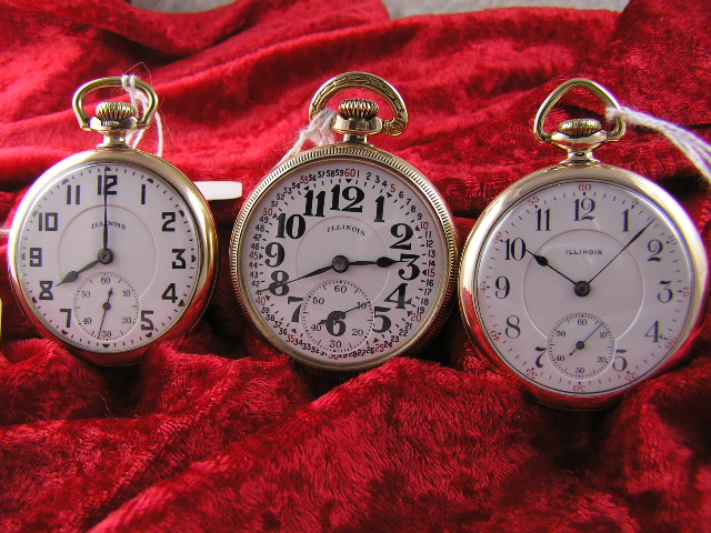

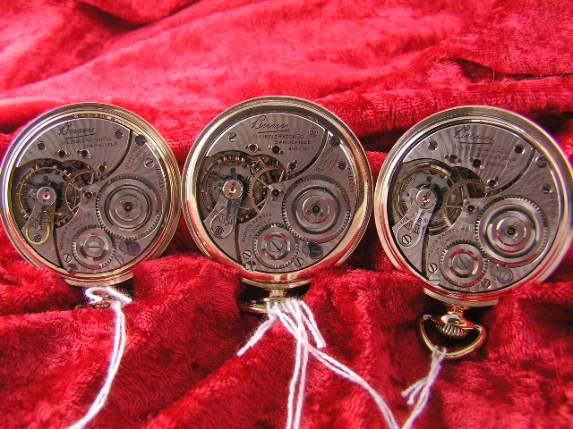

I have finally completed the full set of 19 jewel 60 Hour Bunn watches. It took me a little while and obtaining the Model II came at a price. But when you are so close to having it, and to pass not knowing when the chance will be there again, you just have to go for it. I just haven't seen a lot of these out there and that is probably becaus there were only about four thousand made of the all the models. But here they are: from left to right, the model I, III, II.
April 20, 2008, 17:05
Steve MiddlesworthIf anyone has some critisms as far as what may be non original I would love to hear from them. I do notice the gold whiplash on the Model I and wonder if that was original. Your opinions would be greatly appreciated.

Thanks for words of encouragement. I will keep looking. I had a long phone conversation with Lindell earlier tonight and he pointed out something very interesting about one of the three watches shown from the front. Can you or any of the other members pick it out? I know I would never have spotted it but his sharp eye did. Feel free to see if you can spot what he did.

Tony DukesSteve,
One of the dials is not seen very often.
Tony
April 22, 2008, 22:10

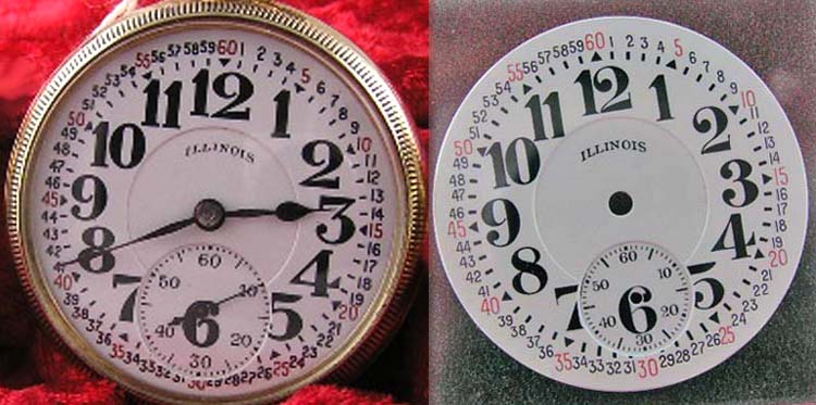

Tony DukesThe montgomery dial in the middle is not a common dial. It is what I refer to as a big six-arrows in-flat top 3 dial. A dial just like the one on your watch sold for $496 in 2006 on ebay. A nice dial to have in your collection.

Steve MiddlesworthTony,
Does this dial fall into the same category? It also has the large "6" and similar style of numbers but the "3" is not flat on top and it is an arrows out. What watch might this dial have come off off?

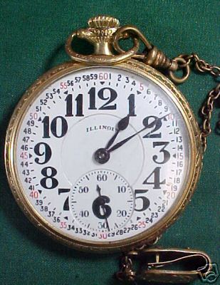

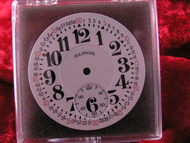

Steve MiddlesworthLindell,
Thanks for your input once again. I did notice many of the diferences but I now see the differences in the size of the seconds sink. How about this next one? The same?

Roger J. NolfeSteve,
Earlier in this thread you asked about the gold whip on your type I. I just picked up a Bunn Type I serial number 4598957 and it has a nickel whip on it. From reading your Bunn Story it looks like I have one of the 750 of this variation.
