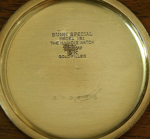

I found a Bunn Special online at vintage watch store. The watch has a Fahy's Model 181 case, but the font used to engrave "Bunn Special" is definitely not like the cursive font seen in all the other Bunn Special cases that I've seen.
Does this look like a legitimate case back? It looks to me like the area has been buffed out and the engraving was added later on.

Edward L. Parsons, Jr.The case signature looks OK to me Dan. Buffing the inside of the case back to remove watchmakers marks is a common practice and that's what we have here IMHO.
Perhaps someone can post a better picture, but here is a Case 181 signature that has the same block lettering as the example you posted.

Daniel ShaoCool, thanks Ed! I like to learn something new every day and this is one for today
I previously thought the "Bunn Special" was always in the cursive script that is far more common.
Since I've opened up this can of worms, I also once saw a Star Model 118 case that was claimed to be an original Bunn Special as well, but without Bunn Special engraved in the case back. Do you know if this would be legitimate?

Richard ZengerIt seems all the Fayhs Model 181 were incorrectly stamped 14k and then restamped 10k. Everyone I see is this way. The two photo's in this forum are overstamped of the 14k changed to 10k. Has this been noticed before.

John C. PettyMaybe not all Model 181 10K’s were re-strikes. Here’s one that looks like it started with an original 10K stamping.

Richard ZengerThank you I just noticed that the one I had and the picture on here were restrikes. I thought is was strange. Thank you for taking the time to show me a non-restrike. I am always amazed at the knowledge and generocity of everyone on this site to be of assistance. Thank again!!!
