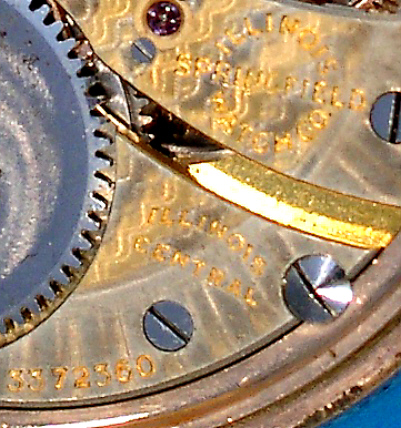

I recently got an Illinois central pocket watch from Ebay. Twas not expensive and I only bought it to play with. I make it to be a 14 size. The book values it at $50. However to me it looks to be a bit better than that. It is double roller. It has a micrometer adjuster and 2 tone plates. It appears to have a gold train. Written on it from the top down is 17 Jewels, Illinois Springfield Watch Co, Illinois Central, 3372360.
The case is 25 year but is beyond help.
Dial has gothic hours with a number for each min as well and red for 5 mins. Marked Illinois Central. Is the book correct or do I have something else?

Would all 70,000 have been marked Illinois Central like this one or would there have been a variety of different names. I checked the price guide and there is a 16s Illinois Central listed but it is a pin set. Mine is pendant set so I am still unclear exactly that this is. Double checked the diameter of the movement and it is 41.86 on the pillar plate behind the dial lip. 43.13 overall including the lip and 40.54 dia at the back. Book says 43.18 for 16 size and 41.48 for 14 size so must be 16 size. I have added a closer picture of the markings.
Thanks Steve

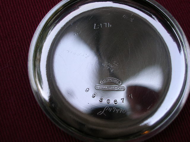

Stephan GaalWatch is running now and I am mucking about with the timing. Meanwhile I have another Question. As you can see the case is rough but I just noticed that inside the back lid in marked I. C. Special. I was about to get rid of the case in favour of a better one but had a sudden thought that it may be a special case that should stay with the movement. Is there an Illinois expert about who can advise me on this?
TIA
October 02, 2007, 23:54
David AbbeWith the case signed too, you have a "triple signed" watch. I would insure that for twice the "normal" value, which puts this in "average condition at about US$125-175.00 in THAT case!

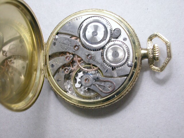

The Roosevelt is different in that the plates and bridges are plain, no damasceneing or decoration at all. I will post a picture later.
Here's the Roosevelt, 17-j adjusted, plates and bridges have a matte finish and the jewel settings look like brass to me. Serial number is 4709857. It's in a 14k green gf case by SWC Co.

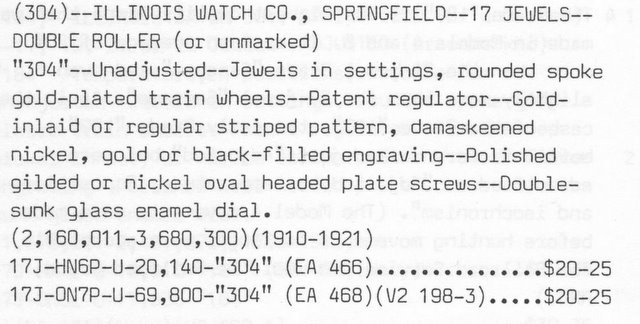

Could tell me what the following line means?
17j-ON7P-U-69,800-"304" (EA 468) (V2 198-3)....
17jewel open Nickel model7 pendant set ? quantity
grade 304 (?)(?)
September 10, 2008, 21:09
Steve MiddlesworthKeith,
I can tell you that the "U" is for unadjusted. The "EA 468" refers to a movement diagram in the Megger's Illinois books. The "V" number I can't explain but if I find it I will let you know.
Steve
September 11, 2008, 00:52
David AbbeThe codings mean; (an excellent system developed by Meggers Ehrhardt)
17j; 17 semi-precious Jewels
O; Open Face
N; Movement finish is Nickel
7; Factory model number or movement number
P; Pendant Setting
U; Unadjusted
69,800; Total quantity manufactured
"304"; Factory Grade number
(EA 468); EA numbered model identicifation drawing (of movement) which is included in all Ehrhardt volumes on watches.
(V2 198-3); Special reference to page and section of Ehrhardt-Megger's Volume 2 Illinois book where this is described.

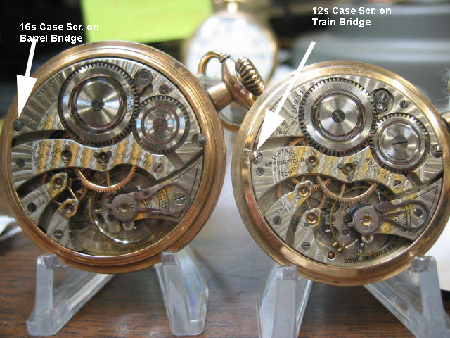

John J. Flahive IIII have a 12s version of the Illinois Central that looks almost exactly like Stephan and Keith's watches. The bridging and damaskeening are virtually identical except for the smaller size.
The serial number of this one is 3141216 which makes it a Grade 404 which had a total production run of 65,910. Not sure how many of those were fancied up and labeled Illinois Central, but I would guess less than 10%.

John J. Flahive IIIAnother picture of the movement:

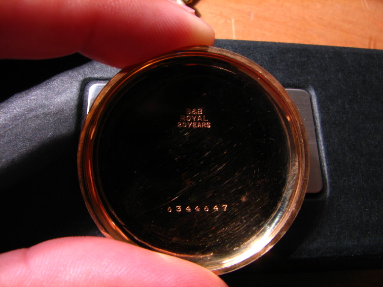

John J. Flahive IIIThe 20 YEARS B+B Royal case may be a replacement, but it works nicely.

David AbbeYou have a rare one, it is #2 known to exist now in thet grade (unless this grade is a typo, as it does note that 204 was also used for "0" size movements.
Regarding the difference between a 12 size and a 16 size, the 16 size has the case screw on the barrel bridge and the 12 has the case screw on the (false) train bridge. Otherwise as they are both two-tone movements they look very much the same.
