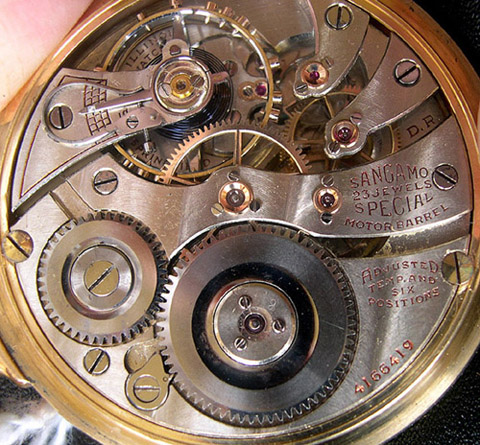

Sangamo Specials data base. We can only imagine the time it takes, but it is appreciated! Below are three pictures of 4166419 my 23j Sangamo Special. I think you can take what you need from these 3 pictures.
Mike

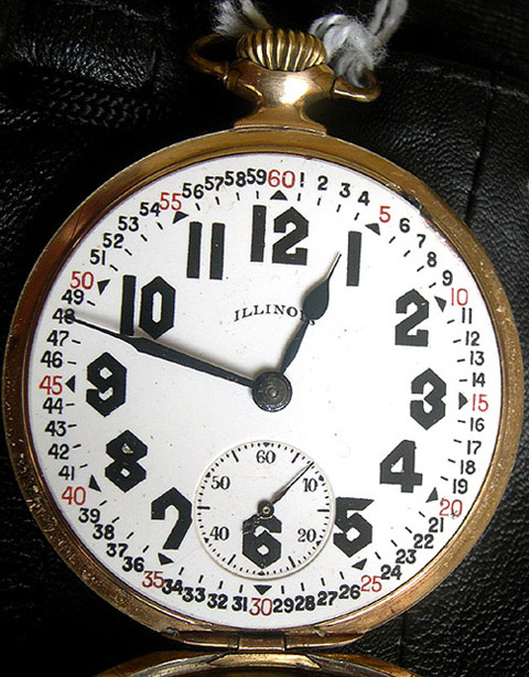

Mike LaForestThe dial.....

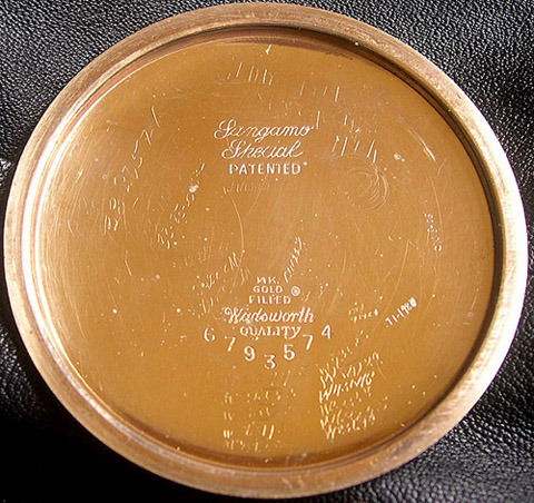

Mike LaForestThe back, Wadsworth case...

Mike LaForestI am concerned that the hands on the 1923 Sangamo Special example I posted above may not be correct. I'm on a steep learning curve. Someone advise me here, please.
Best,
Mike
September 25, 2009, 14:01
Mike,
The hour hand looks to be a bit early, that particular design was not used on Sangamo Specials after about 1918 but it was used on various other Illinois watches until the "Hamilton Influence" hands came into common use during 1928 production. Whereas the minutes hand is the later style and I cannot see the seconds hand clearly enough to make a determination.
September 25, 2009, 14:03
Mike LaForestI was afraid I was going to have some "inconsistencies" with the hands on my watch; thank you, Lin, for taking a close look for me.
Now, I hate to appear foolish, but what is the difference between a rigid bow and a stiff bow? Is there just one rigid bow style and one stiff bow style as appear in 'The Complete Book'?
Best,
Mike
September 26, 2009, 18:24
There were three-hinge versions of "Rigid" and "Stiff" cases as shown in the "Complete Guide to Watches" on page 289 and both were available in gold-filled as well as solid gold. We seem to find fewer of the "Stiff-Bow" and since that bow design is more subject to wear a nice one can be hard to find.
