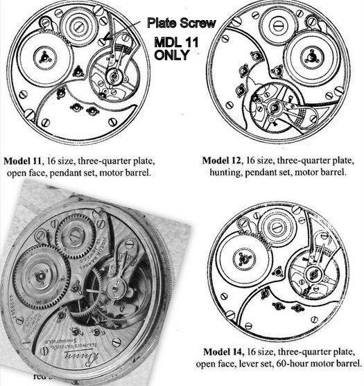

Opinion on the s/n 4598147 16s Illinois Bunn movement pictured, please. I have been looking at these things way way too long, I need new eyes to look for me. Is this a model 11 or model 14?
(Hint the Model 14 may have 1 less barrel bridge plate screw.)

Steve MiddlesworthI have not found that plate screw to exist in any of my model 11's. Go to this discussion
(first 19 jewel Bunn) and you will see it isn't there. That screw would have to be right in the middle of the lettering on the barrel bridge.

David AbbeSteve, I agree with you, after checking all of my movements of that range and then thinking it over, there is no reason for an extra plate screw there anyway. If it were anybody but Townsend doing this drawing I would think it was a practical joke.
