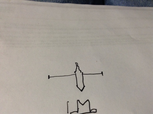

The watch was running when I bought it. But not well. So I took it apart to clean and put a new mainspring. To my surprise. This is what the bottom pivot of balance staff looked like. Someone pointed it and made a brass jewel for it to run in.
January 14, 2018, 17:49
Eugene Buffard
So I gave it to my friend Doug Weaver to straighten it out. He had to reinstall 4 balance screws. And staff and jewel to get it running good.

The watch butcher removed a bunch of screws to over come the extra friction of the bottom triangle pivot.
