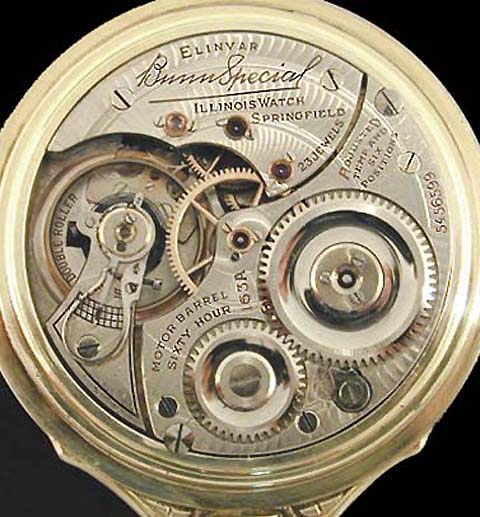

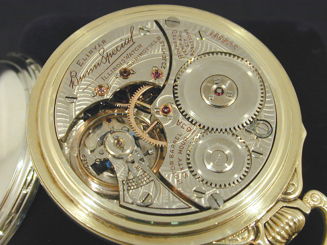

http://cgi.ebay.com/ws/eBayISA...Item&item=4903511764Something looks wrong with this, is the 163A movement mismarked?

Well, well, well...Of course the fatal...
"error in the listing"... was...
"all the numbers match on this beauty"...but on this one we have every reason to conclude the
movement numbers do not match. In all four movement images in that auction the
balance is in motion so we do not know whether or not it has a split or solid balance wheel. With any "Elinvar" movement it is vital to check the balance wheel and be certain it is solid before bidding. The important lesson here may be, when you cannot see it clearly, just walk away.
Interestingly the run the auction movement
5456599 is from 5456001 through 5458000 are recorded as 163A Type II B which the auction example evidently

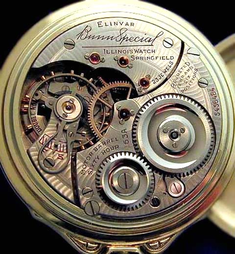

once was. For example, I have 5456484 in my collection which is from that same run and it is shown below for comparison. Tony's question about damaskeening is an important one.
All 161A and 163A Bunn Specials have three circular rings the entire diameter of the movement as shown in the image below. Other models lack those distinctive markings. Absence of a ring continuing through on the balance bridge and having the completely wrong black outline on the balance bridge did this one in. Look very closely and carefully compare the two examples shown below.
Below, carefully examine 5456484 which is correct...June 09, 2004, 17:02
