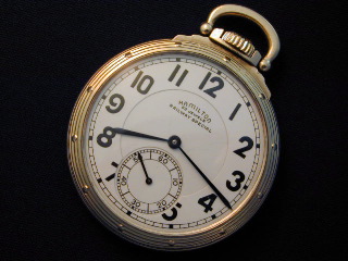

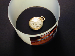

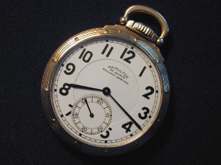

Stephanie, when choosing a camera I asked some eBay sellers who take vast numbers of good pictures what they use.  The Nikon 950 and 995 and derivatives are the overwhelming choices.  The size of the viewing screen, ease of use and extreme flexibility along with low cost are among the reasons I prefer the 950 Nikon.  I use the camera hand-held with ordinary room lighting.
I just use an ordinary desk lamp with a 150 watt bulb.  Nothing unusual or exotic in any way.  Larry's "Ott-Lite" intrigues me and I'd like to know more about it.  Due to the simple lighting I use there is glare and a lot of reflections.  At times I use the center of a translucent jug from which the top and bottom have been removed and simply set it over the subject.  I then take the pictures looking into the jug.  See the three small pictures that follow this message which were taken with a black background.
Below desk light coming from the upper left, not enhanced...August 11, 2003, 14:43
