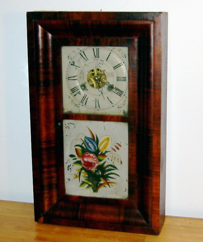

Aaron BereiterA couple of fotos.

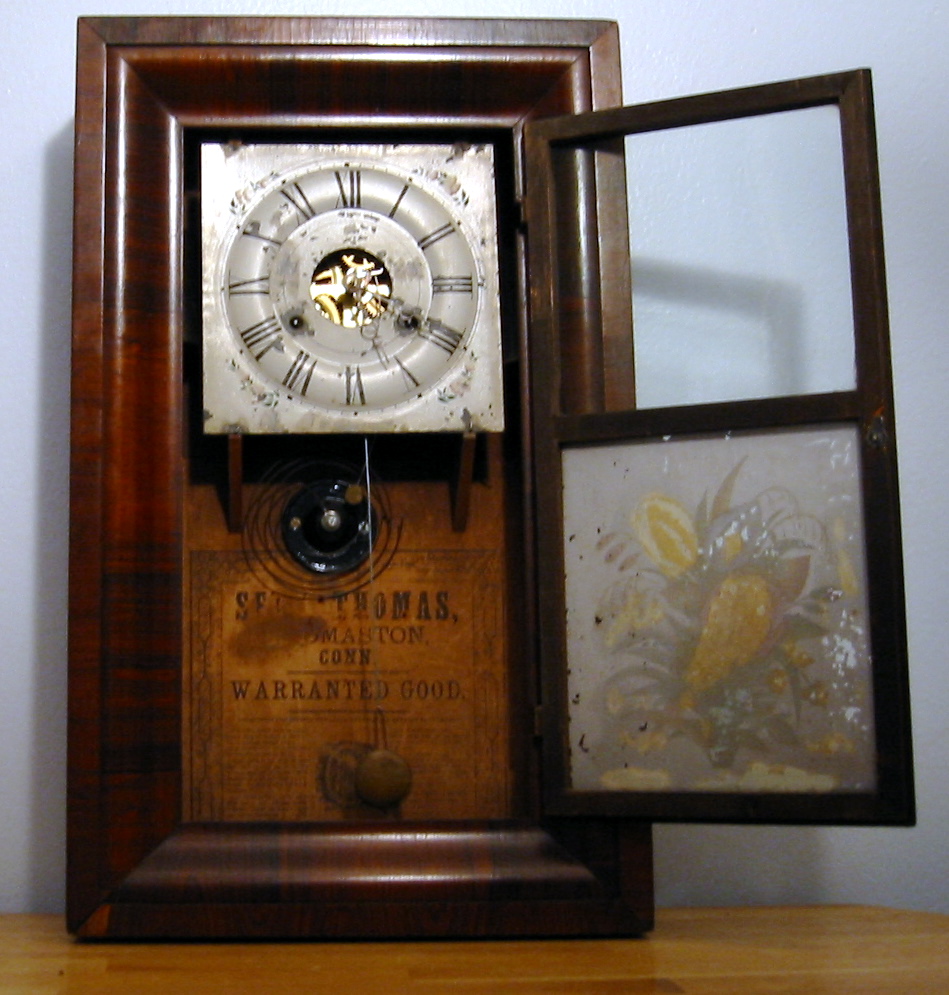

Aaron BereiterAnd another.

Tom SeymourHi Aaron, I just got back in town. There are a ton of emails to go through, but I had to take a look here first. Just a quick response, then, when I get a chance I will seeif I can dig up more.
Clocks don't have serial numbers or grades. The label on this one indicates that it was 1865 at the earliest. The town of "Plymouth" was changed to "Thomaston" in 1865.
If you still have the camera and could get a shot of the movement without the dial, that would be good. When I am more awake tomorrow I will try to track down the movement dates. It is one of the earlier ones (raised rings around the wheels).
