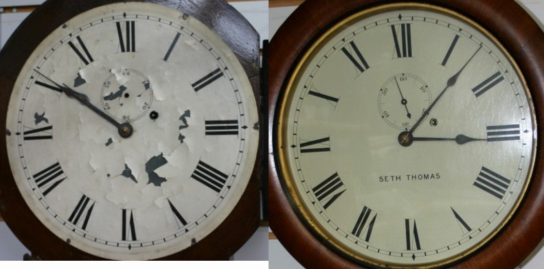

On this particular clock...the paint on the dial is very bad. The owner wants to have it restored.
Having the original dial restored...would mean new paint on old metel, at a cost from $100. to $200.00.
Purchasing a copy from one of the supply houses(new paint, new metel)costs approx. $20.00.
How would this decision determine the ending value of the clock?

I think the original dials on ST clocks went bad due to the paint being applied to Zinc. I don't think the vintage paints had the ability to stick to the zinc.
I hope the painter uses a paint, or primer that makes everything stick together for a while.

Ged PitchfordHello All,Even today paint will not "Take" to Zinc articles in the long term. It is well known newly Galvanised (Zinc Coated) metal, sheds paint after a short while. Many years ago I fitted a Galvanised 4inch dry-riser Fire Main up the West Tower of Ely Cathedral and the Architect made us paint it with MORDANT SOLUTION Before painting it Dark Battleship Grey, a Lead Based paint. The paint wore very well exposed to the elements, as it was.
The Architect , I remember telling me the alternative was to leave it un-painted to "weather" for 5yrs.
I have just done a Google search and find Mordant Solution is still used and recommended for pre-coating Galvanised Items. Regards, Ged.

Greg ReevesHow pleased am I? Thanks to all for their suggestions and references to Martha Smallwood and "The Dial House"!

The dial looks great!!! So much better than a printed replacement. Thanks for posting the picts. I'm glad that it worked out.
