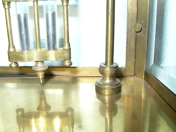

However, while gazing at it the other day...I had a brain storm(or stormy brain). Anyway...take a look at the photo below. I turned the regulator upside down, placed a stronger spring in it, so as to keep the reg. wheel and gear tight, added some spacer to fit and attach the regulating unit to the movement, and am using a much weaker suspension spring. This combines go give me almost 5/8" more room for the pendulum to fit in the case. I'm hoping that the thinner sus. spring will allow me to gain just a bit more.
I know this is not the correct way to "repair" a movement...but! There is no damage being done to either the movement or case.
What do you think? Any more ways to gain space between the end of the pendulum and floor of the case?
