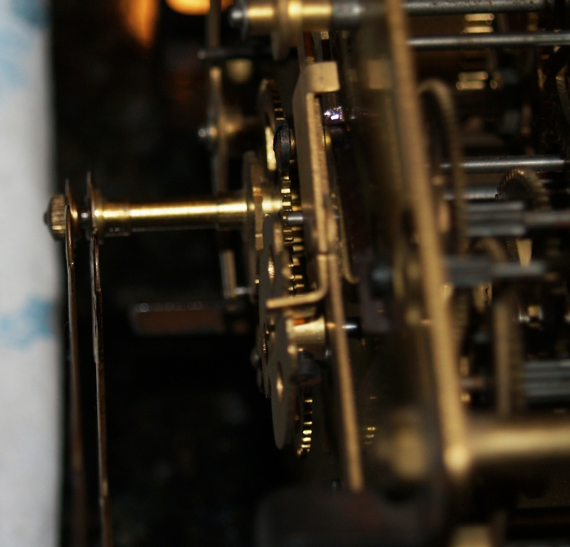

Thank you so much for your response. The minute hand rests on a square peg at the end of the drive shaft. I don't think the front nut actually maintains friction.
The hour hand rests on a bushing that encases the drive shaft and is turned by a secondary set of gears. There is about a 1/16 inch slop for the bushing when the nut is tightened.

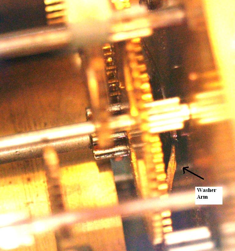

There is a friction washer with three "arms" that emanate from the center. It is tight enough to the train that it moves in synch with the gears.
I tried placing a washer between the nut and minute hand to see if that helped with no results. I did the same between the min and hour hands. This removed the slop in the hour hand bushing, but did not accomplish a fix.
I've put a picture of the clock hands. I will post a separate showing the spring washer.
The only markings I can find on the clock is the number 1219 on the back.
Picture of Clock Hands

Picture of spring washer

Hmmmmm, I'll have to dig one of my old movements out and take a look, I wrote my checks from memory, so may have missed something.
What you could do, is let down the mainspring on the time side, then take off the back cock, then lift out the pallet arbour and crutch (pallets will be attached).
If you give the train a light wind again, this will allow the train to freewheel so you can observe what's happening - or not as the case may be.
I had a similar problem with an old Enfield type mantle clock, and the motionwork had shifted somehow sufficient for the gears not to mesh.
The clock was ticking away, but the hands not moving.
Can't for the life of me recall what the exact fault or fix was, but it was easy.
I'll come back with some ideas when I've pawed a movement.
Best regards
John

You are partially correct. I finally got the nerve to take the movement apart. There is a "dished" washer with four arms that reach off of it to provide friction against the drive wheel, and a brass bushing that you press onto the cannon pinion to hold that washer against the wheel. I have surmised that this bushing is worn, and/or the pinion is worn to the point that they will not keep enough friction to drive the hands.
So the question is now, where can I possibly find a new part? I am not without skills, but these parts are far too small for me to mill.

GREETINGS DEREK, YOU HAVE TO REMOVE THE 4 LEGGED RETENTION SPRING AND GENTLY BEND EACH LEG DOWN A BIT WHICH WILL GIVE YOU MORE HEIGHT AND COSEQUENTLY MORE TENSION.IF IT IS A BUSHING THAT HOLDS THE SPRING YOU SHOULD CHANGE THAT AND ADD A PIN THROUGH THE SHAFT A SMALL PIN. WITH THE SPRING IN ITS FREE STATE AND RESTING ON THE BACK OF THE GEAR MARK THE SHAFT AND THEN DRILL A SMALL HOLE ON CENTER 1/16 OF AN INCH BELOW THE MARK AND INSTALL THE SPRING AND INSERT THE PIN. THAT WILL SOLVE YOUR PROBLEM. IF YOU FEEL YOU NEED A DIFFERENT SPRING LET ME KNOW I HAVE SEVERAL. GOOD LUCK. EDDIE
