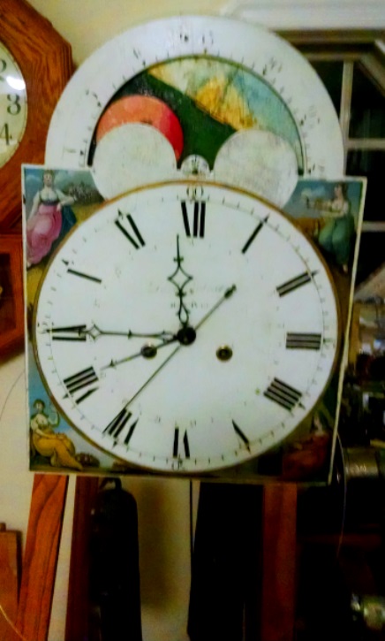

Finished cleaning and doing some minor repairs on this clock (new cables, straighten pendulum rod and suspension spring, straighten second hand arbor, straighten arbor third wheel strike side, straighten escapement wheel arbor, remove numerous finger prints, and clean up battered screw slots) and thought people might find it interesting. The false plate is by Walker and Hughes, Birmingham, but the dial is labeled David Gottleib, Hanover. The clock was donated to the Union MIlls (Carroll County, Maryland) Homestead, in 1975 by someone who stated it had been in their family since new. The Union Mills Homestead Museum Director believed the clock to date to 1800, but Walker and Hughes were only in business from 1810 to 1825, so the clock cannot be older than 1810. David Gottleib was a clock maker working in Hanover, PA from about 1800 to 1850. The unusual feature of this clock is that it has a center seconds hand and a center calendar hand. The calendar is actuated by the back side of the roller moon dial actuator, driven off the hour pinion. Here is a photo of it, on my test stand. The replacement cables are not tied off yet, because I forgot to measure the case. When I replace the movement in the case (sometime next week) I will tie off the cables so that the weights are always under tension, even when the clock is fully run down. (That is the only way to keep them from tangling on the barrels.)
