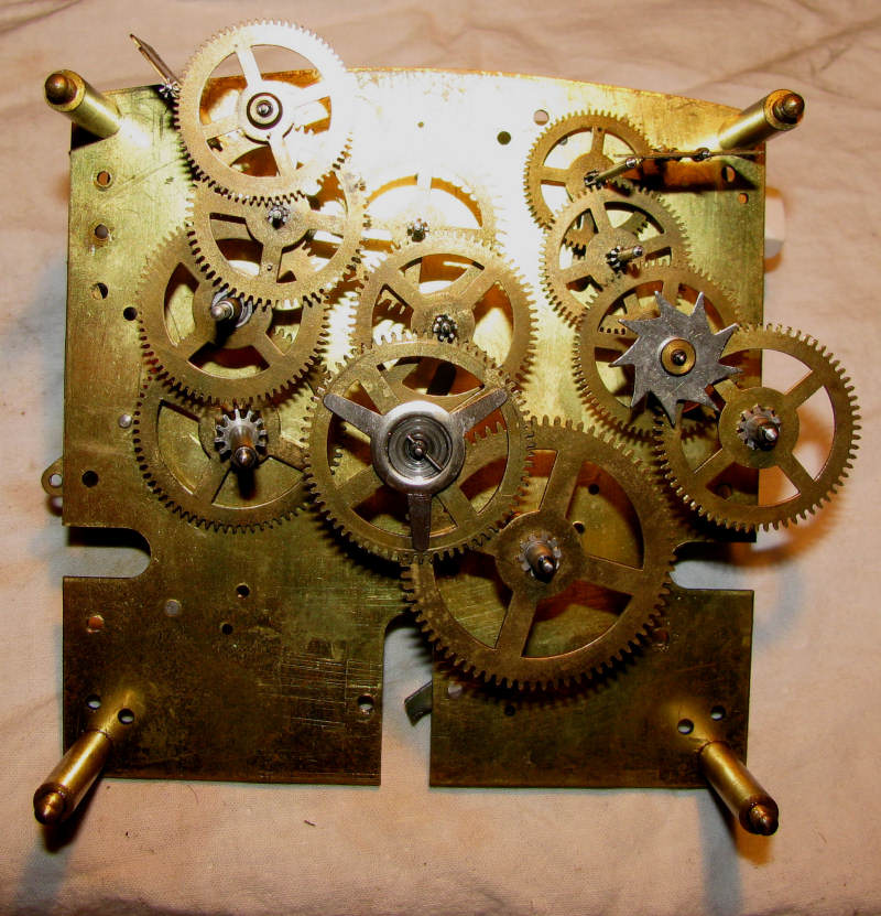

If you hold the minute arbor and push the wheel,(with the pallets out to allow the time train to freewheel) it shouldn't budge too easily, so you can check this easily enough before you dig deep.
The photo attached is of a 3 train Westminster movement from a 20's Granddaughter clock, the spider and pin arrangement can be seen on the central wheel.
John
