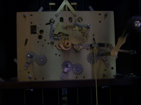

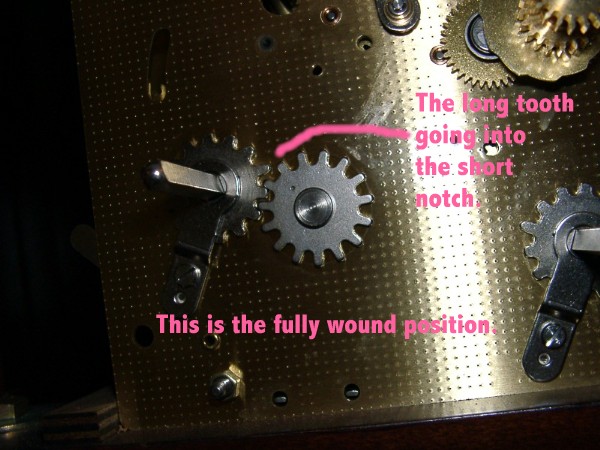

Tom SeymourHere are a couple of pictures of the stops in a Sligh cable wind grandfather clock.
The arbor is wound clockwise and has stopped and dropped back a bit to the closest click position.
February 11, 2005, 18:04
Tom SeymourThis shows the three winding arbors and their stops.
