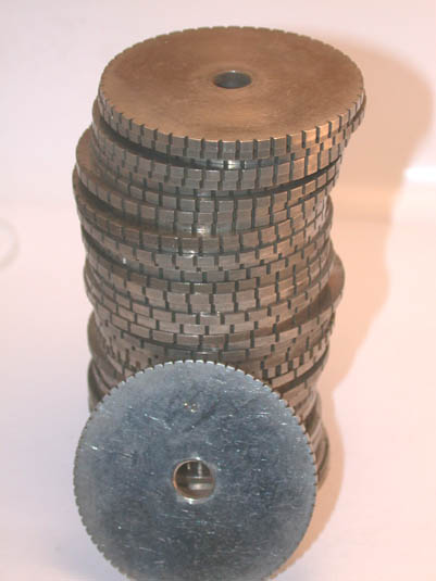

Are these clock index cutting wheels?
https://ihc185.infopop.cc/eve/forums/a/tpc/f/6346047761/m/2551046522
January 04, 2007, 21:48
Ernest C. Barnes
Left to me by a retired clock maker. Are these used to make clock wheels?
January 05, 2007, 17:21
Peter Blunsdon
Ernest,
I'd confirm your thoughts.Used to index a blank wheel for cutting.
They would likely be attached to a cutting frame or maybe mounted on the back of a lathe mandrel. A small lever with detent would select the particular notch. Much more commonly seen as a dividing plate with rows of holes. I use gear wheels on my Myford similarly.
