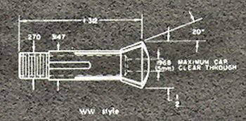

Still looking for a description of the Wire Collet.
July 27, 2004, 14:31
Kevin PestorThanks for the images Wayne, quite interesting.

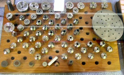

Wayne C. AndersonAnother picture of different watchmaker lathe collets.
July 30, 2004, 15:56
Kevin PestorNice Wayne, wish i had all those collets for my peerless lathe, any idea what the big faceplate or chuck on the right is used for?

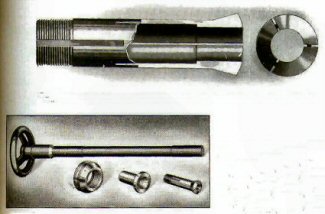

Wayne C. AndersonKevin,
In my catalog, this is how they show the face plate usage.
August 06, 2004, 18:38
Wayne C. AndersonThe draw-in collet chuck is the most accurate of all types of chucks. The work held in the collet should not be more than .001 in smaller or .001 in larger than the collet size or it could impar the accuracy of the collet. A separate collet should be used for each diameter of work.
