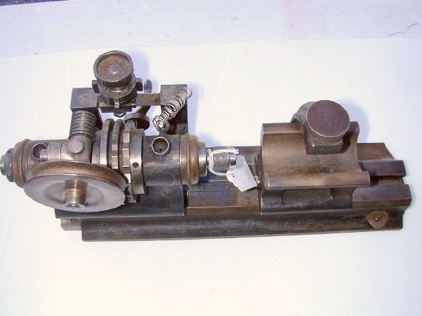

Carlos FloresJessica,
Thought that you would like to see this
damaskeening lathe at eBay.
