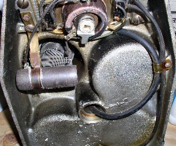

Wayne, I have a question. In the picture that you provided,is the 50hm resister you refer to ,the one on the left ,being held in place by a strap.Or is it the rehostat shown in the picture.

Wayne C. Anderson
Frank,
The wire wound resistor is on the left side, supported by the meatal strap/bracket. The speed control rehostat is at the top of the photo.

Bob Nickles
I guess I should have said rehostat,after seeing Wayne's picture. I am not familiar with electrical parts. I thought the parts were made just for this machine and may be out dated. I will try an electronics supply. Thanks for the help.

Wayne C. Anderson
Frank,
The heating resistor in my unit is 3 1/4" long x 1 1/4" dia (approx) - no markings but I think its rated at 50 or 100 watts.
Bob,
I don't know the resistance rating of the rheostat but it is wire wound so I'm guessing 50W or 100W power rating.

Wayne C. Anderson
The heating resistor in my unit is 3 1/4" long x 1 1/4" dia (approx) - Checked with VOM and in my unit it measures 200 ohms.
Bob,
Measured the rheostat with a VOM and its 50 ohms.

Thanks for the help Frank and Wayne. I thought I had the problem solved. I went to a couple of local electronic supplies and found a replacement for the rehostat. The one I took out had only two conections(one had been cut off) the new one has three. Is the rehostat in your machine only coneted in two places or is mine a homemade repair.

Wayne C. Anderson
In my unit, the rheostat has two connections, the moving arm, and one end. The other end can be left open, or cut off if there is a space problem...

Bob Nickles
Thanks for your help Wayne. The machine is now running.
