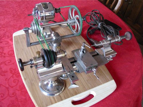

I finally got around to setting up my new lathe. I've had the parts for months, but just got around to putting everything together. I have the lathe training DVD's by John Tope, and one of his suggestions was to use a cutting board for a base. Went out and bought one for $12.99 and it worked out very well. I put rubber feet on the bottom so it would stay put when I fire it up. I've already used it to clean up a very corroded nickel wrist watch case back.

Edward L. Parsons, Jr.Nice setup Bruce. My own background as a machinist is on bigger equipment, but the principles are the same.
Belt drives are easy to adjust and vibration-free. What (if anything) do you use for cutting fluid?

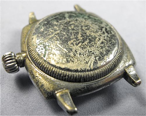

Bruce StewartEd, I am just a beginner when it comes to using my lathe, but attached are photos of one of my first attempts. This is the restoration of a 1929 Rolex Oyster case. I used a six-jaw chuck to hold the case back. Probably unorthodox, but I turned it down using various grades of dry sandpaper glued to a popsicle stick. The chrome plating (over nickel) was quite hard and it took about 1/2 to get to where I am now. I still have to do final polishing to get rid of the micro-scratches. My other project was with oil and a stone. Had to turn down the bearing surface of the center wheel staff on an 18s Illinois. Reason for that was because the big holed jewels are no longer available and I had to put in a jewel with a smaller center hole. Shaft only had to be brought down a few thousands. Anyway, here is the "before" shot of the old oyster.

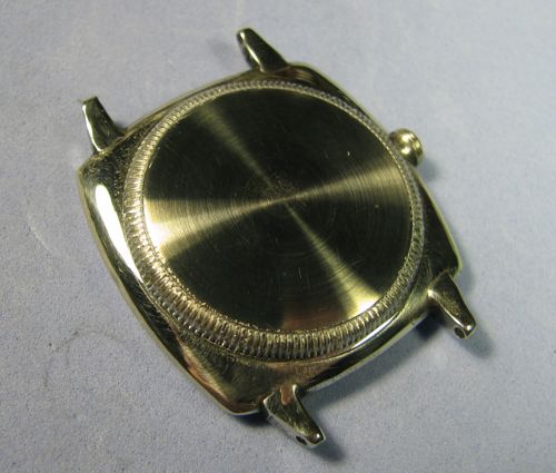

Bruce StewartHere is the after. As previously stated, finish polish still needs to be done.
