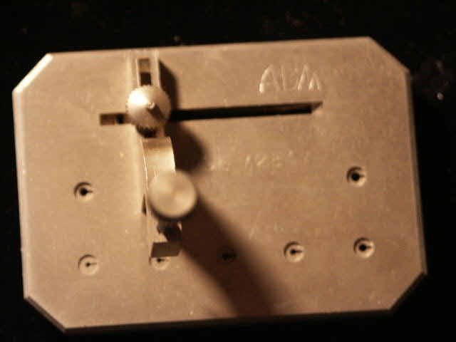

Does anyone know what this tool is for?

Kevin PestorWould i be way out if i said studding table.
I am just guessing on that one.
I am sure someone else will know what this tool is for.

Sam WilliamsonMy money's on a colleting table;notice the openings for the gap-would love to have this baby!

Jerry TreimanI found this tool in my Bergeon tool catalog. It is titled: "Press for making guidemarks on balances"
Those recesses visible in the table have slots that apparantly allow a roller table and jewel to drop in, and I think they are adjustable in height. I think the "guidemarks" are the punch marks in the rim of the balance to show where the roller jewel and hairspring stud are set.
If you have ever had a chance to look through their complete catalog, they make an INCREDIBLE number of very specialized tools. Most of us just make do with something else for that once in 5 years need.

Wynter SturtevantGood find Brian. It's really an odd ball tool.
Jerry, What Catalog are you looking in? I've got a May 1949 Bergeon catalog and it's not listed.

Jerry TreimanMy set of catalogs do not have a printed date that I can find, although someone date-stamped one volume in 1975 and another in 1981. It is a black, soft-bound 3-volume set (vol. 1a, 1b and 2). The tool appears on p.7039 in v.1b It is item No.4663 My catalogs do not include price lists.
