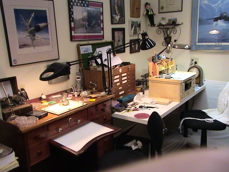

At our shop, on Cherie's bench we used a piece of T-Shirt cotton because it is easier to "bounce and see" the teeny parts without them bouncing out. Of course I use my velcro apron (as at home) on my "Cheapo" bench. I like it because it is identical to the home bench in all ways, and somehow that makes it easier to work at either.

Steve MiddlesworthDave,
Nice set up you got there. My question is, do find the lower left hand drawer a hindurance as far as leg space goes? I was kind of thinking of centering that "catch" shelf in the center of the working space in my design. I have kind of wide legs and I'm a furly big man.
Steve
July 29, 2008, 21:00
David AbbeSo am I and I fit fine when I look at someting at that bench.
July 29, 2008, 21:39
Edward KitnerDavid,
Nice watchmakers bench.
How high is the top from the floor?

David AbbeEd the height of the Watchmaker's bench and the low cost workbenchs (with table added) are all about 42" (1.07 m) above the floor

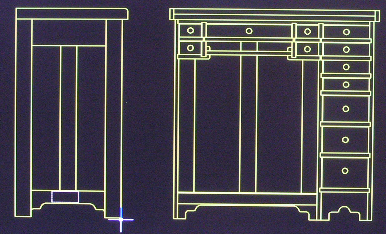

Steve MiddlesworthHere is a crude photo of the design on the computer screen. I couldn't get a dark enough print out on the printer....need to play with the parameters more or something. Anyway, basic design....it will need some refinements but is drawn to the dimensions that Roger gave me.

Roger J. NolfeNice design Steve...That will be one sweet bench!!

David AbbeEd, you are indeed an artist. I think working at a bench that is that nicely thought out, must also "telegraph" into better work done!
btw, I got my aprons at WalMart for $3.95 each. I sewed the velcro to the aprons (with the apron pcokets turned in "facing my tummy") and "glued" the velcro to the benches with "goop" which adheres well to the acrylic-based finishes.

I just noticed in your pic that you have a sheet ( or something) under your bench. I was thinking about that yesterday when I lost a ratchel wheel from a very small womens w/w, still haven't found it! I was thinking about a painters drop cloth. Light colored and heavier than a sheet.
December 08, 2008, 17:07
David AbbeI made a white drop out of some 36" wide llightweight white cotton material and then draped it up the walls. I use a transparent vinyl floor mat for the chair to roll on where my chair rolls around. I wear soft muckluks so if I DO drop something I will have less chance of damaging it while looking for it.
