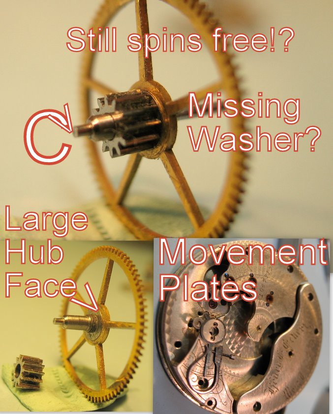

Hello!
I have a problem with Hampden 18s center wheel, pinion is not locked but rolling, the some of safety pinion of waltham when is unlocked.
I not understand how fix (lock) it, can some one help me?
Thank you!
Fabrizio
December 26, 2009, 16:40
Cecil McGeeThe pinion shaft should be threaded,and the gear should turn until it seats at the bottom of the threads. It may not be catching the threads. Try pushing down on the gear as you turn it. The direction of the arrows in your photo should be the right direction to tighten it. Counter clockwise.
December 26, 2009, 19:07
Fabrizio Di Claudioquote:
Not work, i can't fix it
Thank you
December 26, 2009, 19:34
Fabrizio Di ClaudioI fixed it ( i hope work and used correct mode ) i used staking tool and hammer on point 3.

Fabrizio Di ClaudioHello David Abbe, in my pignon the whasher is present. After using the staking tool, the pinion turns in one direction and is locked in the other, works well.
