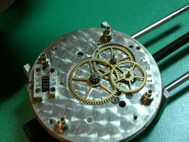

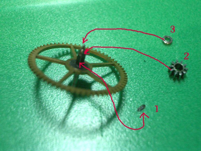

Hello!

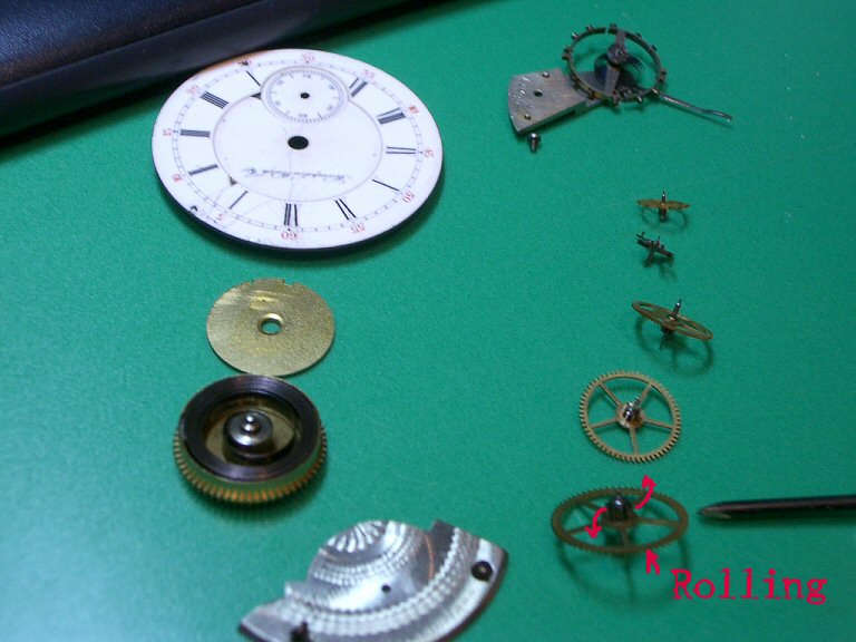

I have a problem with Hampden 18s center wheel, pinion is not locked but rolling, the some of safety pinion of waltham when is unlocked.
I not understand how fix (lock) it, can some one help me?
Thank you!
Fabrizio
Posts: 77 | Location: Torino in Italy | Registered: January 23, 2008
posted
The pinion shaft should be threaded,and the gear should turn until it seats at the bottom of the threads. It may not be catching the threads. Try pushing down on the gear as you turn it. The direction of the arrows in your photo should be the right direction to tighten it. Counter clockwise.
Not work, i can't fix it Frown
Thank you
Picture of Fabrizio Di Claudio
posted
I fixed it ( i hope work and used correct mode ) i used staking tool and hammer on point 3. Smile

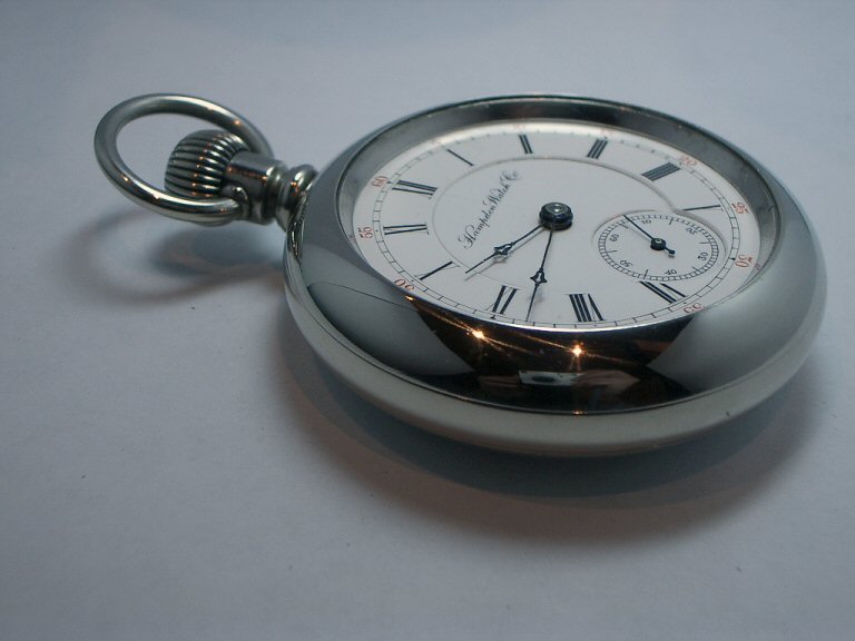

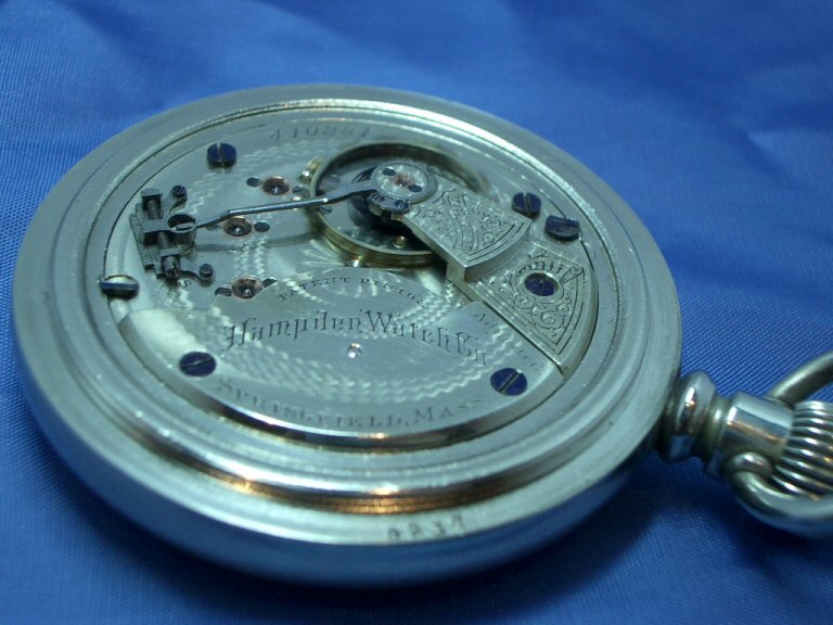

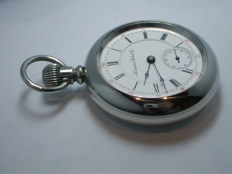

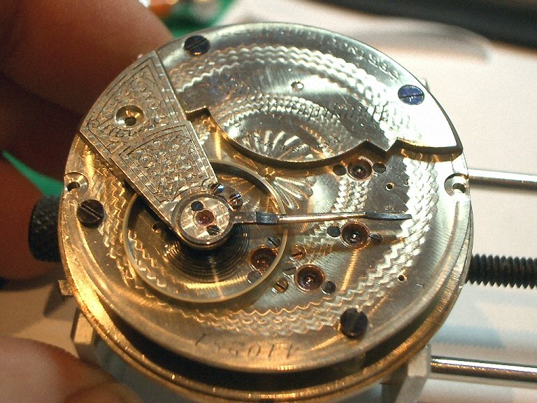

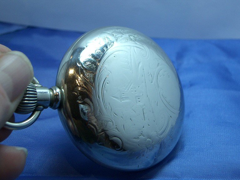

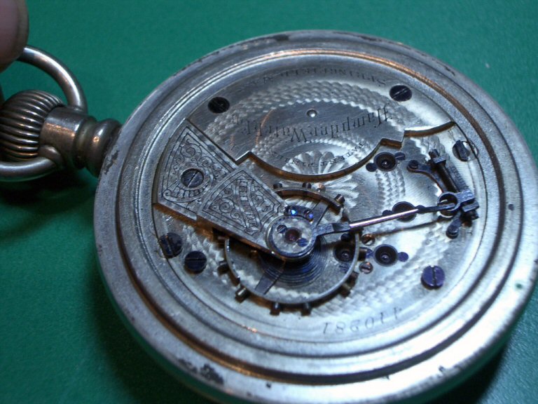

Hello! I Restored it, now working strong Wink
HAPPY NEW YEAR TO ALL AMERICANS FRIENDS OF IHC FROM ITALY!

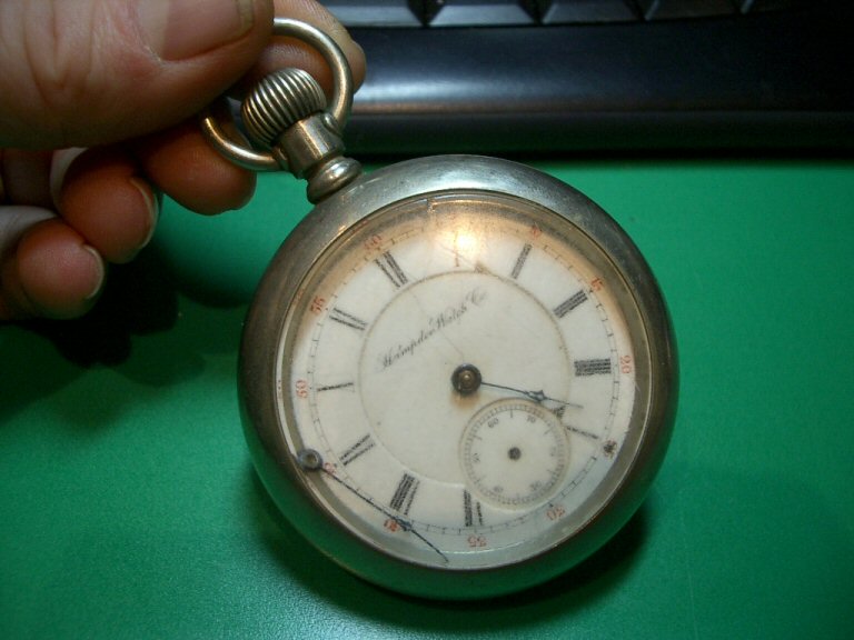

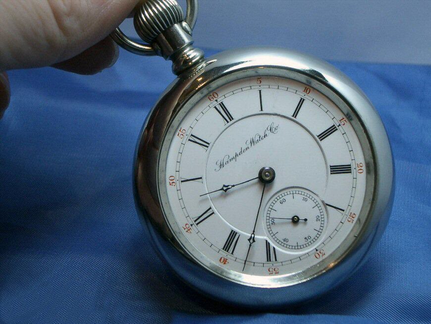

Fabrizio, That watch is a handsome watch indeed and you did a great job fixing the dial! Your posts are a pleasure to see! Happy New Year to you and ALL IHC185!

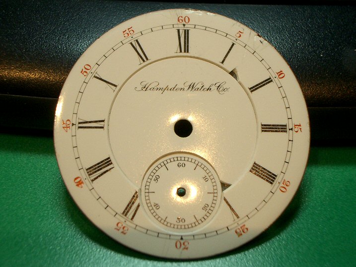

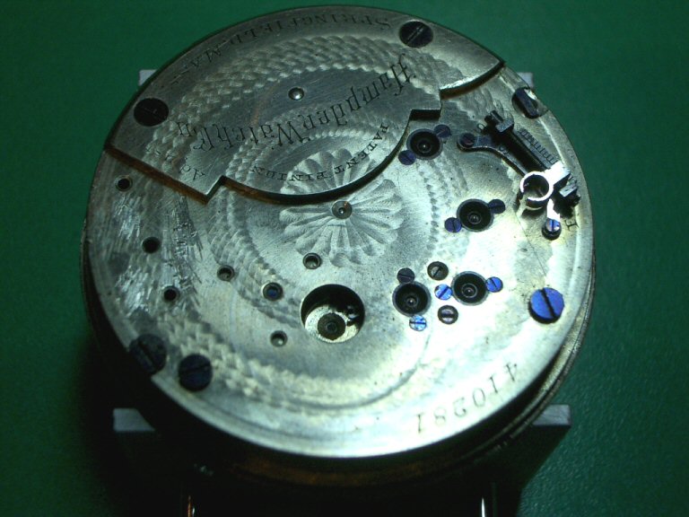

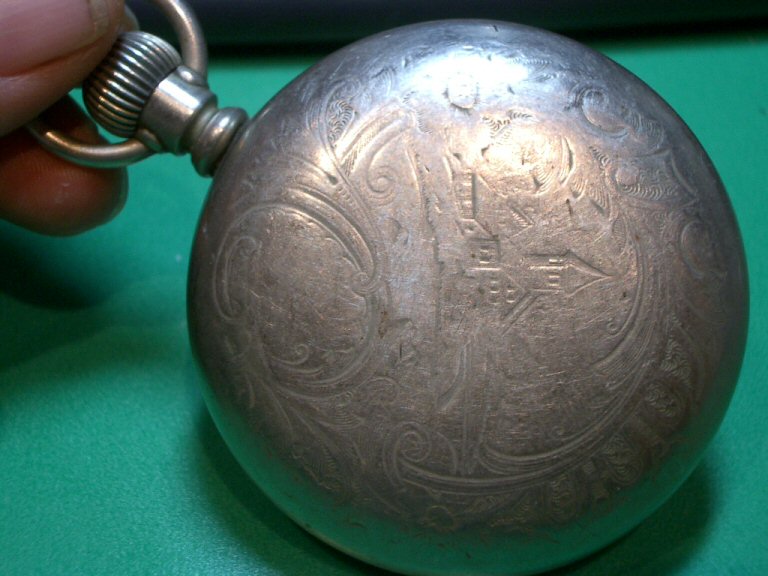

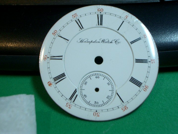

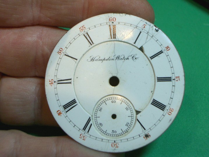

Hello David Abbe, in my pignon the whasher is present. After using the staking tool, the pinion turns in one direction and is locked in the other, works well.

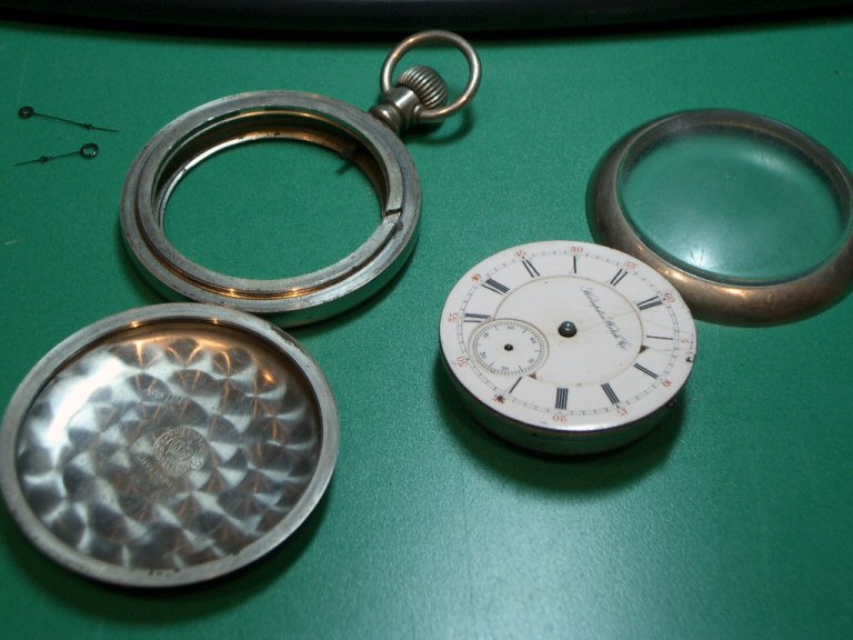

I repaird the dial with WWW.SELVA.DE ceramic dust, first i cleaned it with "bath cleaner"
First
After cleaning
With ceramic dust (using alcool lamp )
Thanks!
