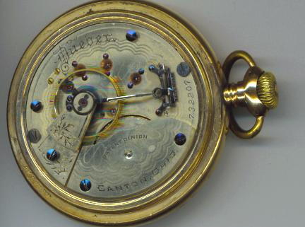

Lawrence FureKenny,
Thanks for the reply.Here's a scan of the movement. Unless there are missing jewels on the pillar plate side my guess would be that this could be a 17 jewel. I'll know more after I clean it.

Tom McIntyreWith no jewel in the center it is unlikely to be 17J. If the pillar plate is not jeweled, it is 11J. If the pillar plate is jeweled, it is 15J.

Lawrence FureTom,
I have it apart now and the jewel count is 16. The center wheel is jeweled in the top plate but not in the pillar plate. It also has a hairspring stud like a Hamilton. Did Hamilton make watches for Dueber at first?

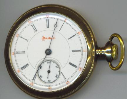

Kenny DraftsLarry,
I`ll stick with my first post except for the gilt movement. The dial looks correct for the movement also.

Scott CerulloLarry, Your Hampden has one of those "Teske Regulators on it."

Brian C.Larry,
Hampden did make a Dueber grade, 18s, 16 jewels, h/c, model 2, lever set. Yours did not list as such in the Hampden Watch Co. serial number book. Where you have the watch in hand, I'd say the book is wrong.

Kenny DraftsLarry,
I had typed a reply earlier today but when I clicked to post it the site was down. I posted my second reply without seeing yours about it being 16j.
Brian is correct, there is a 16j listed for this model. The center hole didn`t appear to be jeweled (bad eyes, dark monitor). Shows how wrong one can be without an in-hand inspection,
Never heard of Hamilton making movements or parts for Hampden so would think not.

Lawrence FureI guess the hairspring stud had me wondering.Thanks for all the information.

Mike PaynterAs far as Hamilton goes, one of Hampden watch designers went on to a long career with Hamilton after he left Hampden. Ed Thouvenin is writing an article on this very fellow and the similarites between the balance cock on both (I forgot the fellow name- I will get it tomorrow). Mike
