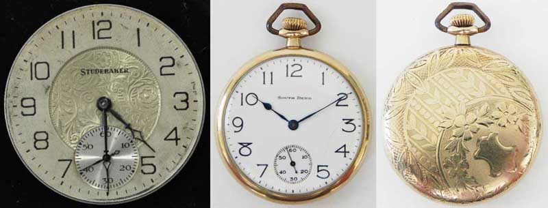

I'm new at this and am not sure if I'm using the proper terminology in my question and if I understand exactly what you mean. Basically I want to know if the movement on the left as you see it would fit in the case on the right and be able to use the stem/crown/pendant you see on the 429 case? Greg ![]() | |||
IHC Member 48 |
Yes, you will be able to switch those two movements and have the Studebaker fit into that case. Be carefully when unscrewing the detent screw not to unscrew it completely. | |||

Thanks Keith, That's great. I've already bought the 429 (for $90 I figured I couldn't lose) but wanted to wait until I was sure about compatibility before forking out the $200 (with shipping to Canada) they want for the Studebaker. I'm sure that's probably too much but I really like the gold 'tapestry' pattern on the dial. Is it possible to clean the dial up a bit or is that the way it'll stay? Greg ![]() | |||

That metal dial is a hard one to clean. The best thing is to just wash it with soapy warm water. Pat it dry and with a soft cloth. Do not keep it wet for to long, otherwise you may clean off the painted Studebaker label. The dial looks fine as is IMO. | |||
IHC Member 1752![]() |
Thanks Eugene & Keith, Yes I did read about a wash with soapy water but I agree that it really doesn't look bad enough to risk rubbing off the Studebaker label. I also read somewhere that a gentle wipe with thin oil will sharpen up a dial. Have you heard of doing this? | |||
