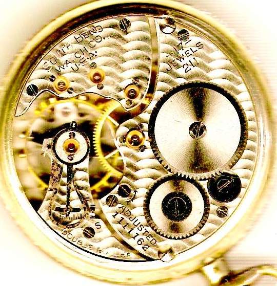

Is this South Bend 211 a fake?
I tried to look the serial number of this south Bend grade 211 watch up in the serial number database and I got an error message that the number is not in the South Bend Range of numbers.

Ernie,
I believe this South Bend movement is the real deal.

Ernie,
Your watch is indeed genuine, however I too found the same glitch in our database.

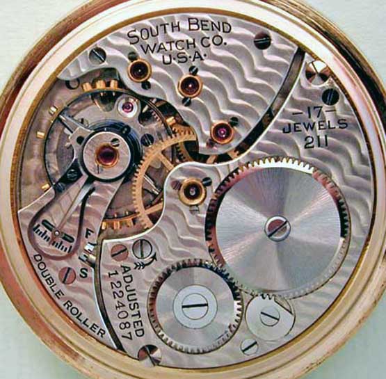

Apparently a whole series of numbers in that one particular run are not showing as they should, so I left a message for Frank who I am sure will run this issue to ground. Typing in a Grade 211 of mine which is 1224087 all the runs of Grade 211 came up, including yours with this information...
1108001-1113000 shows up as being Grade 211 and 16-size, Model 2, 17-Jewels, from 1925 production, your movement is from the 36th of the 38 Grade 211 runs.
Grade 211 from the final 16-size South-Bend run...
