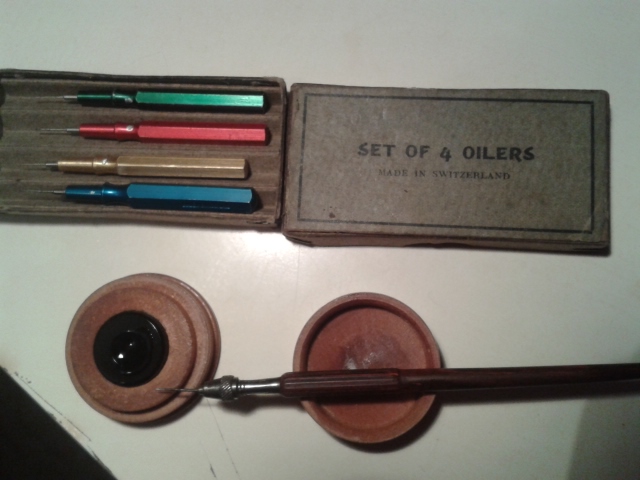

Hi Peter, i may be new but i love good tools, i have purchased good oilers (old), good screwdrivers (old), bought on that auction site yesterday a poising table(old), and i have a beautiful staking set, (old again) unfortunately i must confess that my oil is also old but seems ok.
i'll send you a pic of the oil to give you and everyone else a laugh.

Todd Verriere
my oil, please don't yell at me,

I have same bottle of oil but I use new oil and left that one as decoration piece.

i knew when i did it it was wrong to use that old oil, but these are just practice movements and i haven't yet purchased good oil. can someone suggest what i should buy and for what purpose?
