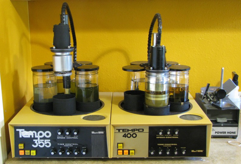

Chris AbellScott, I think you just about covered it there, the more parts you strip down the more you can clean and inspect, I often will machine clean with cap jewels in place then afterwards split so I can hand clean and know they are completely free of gunk, cleaning fluids and nothing washed back in or trapped residues that way. jewelry cleaning tanks etc are ok for basic home use will be different power levels etc cannot beat a correct designed for use watch cleaning machine for quality and safety. Using the correct non destructive cleaning fluids is more important than if it spins or ultrasonic action. For me also Zenith makes the best. Here is a photo of my favorite cleaning machines I use, fully automatic, with oscillating rotation and ultrasonic, I run typically 6 mins per jar for most, and control the speeds of each depending on what I have in there
