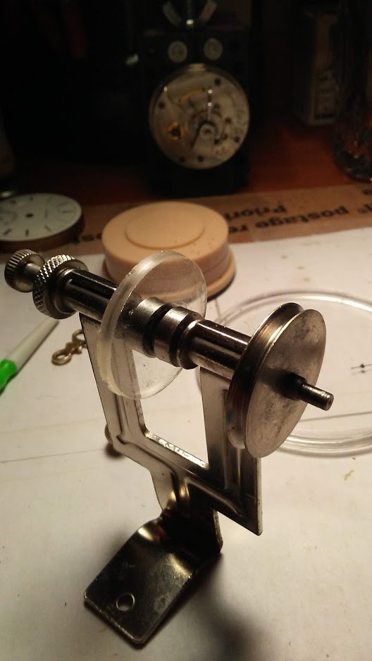

James , I too have 300 crystals and not the right one ! William White is our resident crystal man , he is actually making new crystals , search his posts . I do some stained glass work and almost every piece is ground to fit and remove burrs , I use a "wet" diamond burr , the wet is to keep silica from killing you , it's just a sponge touching the wheel . So grind away ! I also have this little gadget , but have not put it into use , I was thinking of using a stone on a hinge for the grinder

William White here. You can successfully reduce the diameter of a glass crystal using #400 silicon carbide (wet-n-dry) sand paper taped to a wood block. What you'll need to do though is spin the crystal somehow. A device like Kevin's would be ideal. Here's a link to a short video showing the setup I use for holding crystals during beveling and finishing operations:
HERE
What's important to remember is that silicon carbide breaks down quickly when used with glass so keep it moving and continually introduce fresh grit to the work. Keep the surface of the paper damp but don't use too much water; if the paper appears wet then it's too much and the work will be over-lubricated. Once you achieve the diameter you want, simply polish with a worn area of the paper. This will work quickly and leaves a well healed, chip free edge. You can also just do this by hand but it's going to take a lot longer.
