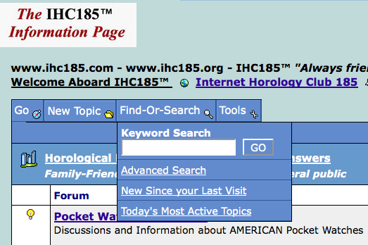

Additionally, one of the great assets of our site is the "Find Or Search" feature which will bring up previous discussions relating to a specific topic.
