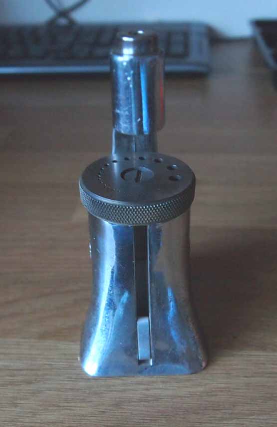

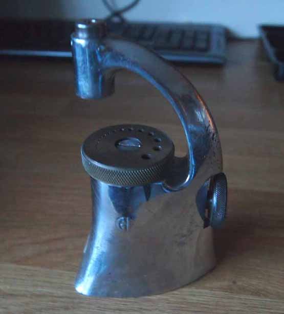

I have recently purchased a staking set. Not in great condition but I am in the process of refurbishing it.
The only identification is a monogram on the side "GF" and beneath "Patent Applied For USA". Most of the punches are marked G@F and numbered plus a few K&d punches.
I am at a loss as to what all the bits are for but am sure that I will find out eventually.
The holes in some of the punches are minute as are some on the table and have assumed these to be for very small wristwatch work. Am I correct or have I got the wrong set for pocket watch work?

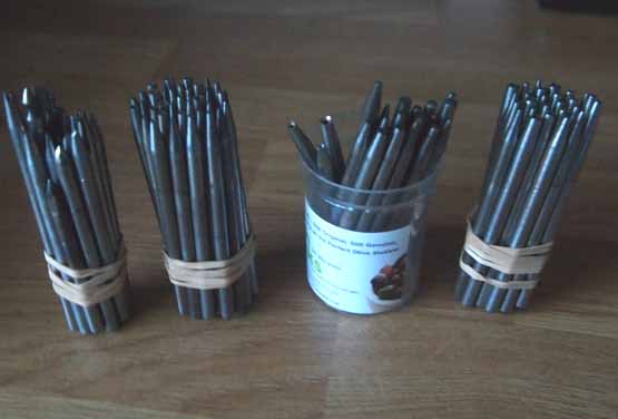

The various punches are :=
13 odd shapes which I think are for fitting roller jewels, chisel points, etc.
8 solid domed
9 flat ended
3 with holes but inward conically shaped, like a volcano crater
34 flat ended with holes through
26 domed ended with holes through
So that makes a total of 93 punches.

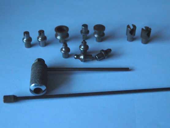

Plus 11 stumps, 4 with holes. 4 flat, 1 domed and 2 with weird slots.
And finally a rod with the end which sees to fit over the punches.

Also there's a slot down the front which did have a spring but It's broken off. Any idea what that's for.

The slot in the front looks to be an inverto set up but it should not have a spring in it.
Picture 4 should have a punch that has a long tit on it to fit into the staff tool. The stumps look to be standard for most sets.
It appears to be a fairly complete set, but I don't know about the inverto part.

Likely 100 punch/20 stump assortment. Not a watch repairman so I don't know exact uses. Descriptions self evident. Punches can be inverted in punch stand to do work from bottom.
Punches are .187" dia. x 3.125" long. Smooth shank, stamped with number parallel to shank at hammer end, followed by GF logo.
#1-#31 Round nose hollow
#41-#71 (note no #32-#40) Flat hollow
#81-#90 (note no #72-#80) Round solid
#101-110 (note no #91-#100) Flat solid
#141 (note no #111-#140) Small roller
#142 Large roller
#145 (note no #143-#144) 3 corner
#150 (note no #146-#149) Large cross hole
#151 Small cross hole
#160-#161(note no #152-#159) Peen
Locating (centering)
Punch selector (tubular extractor)
20 Stumps including roller removers (???)
